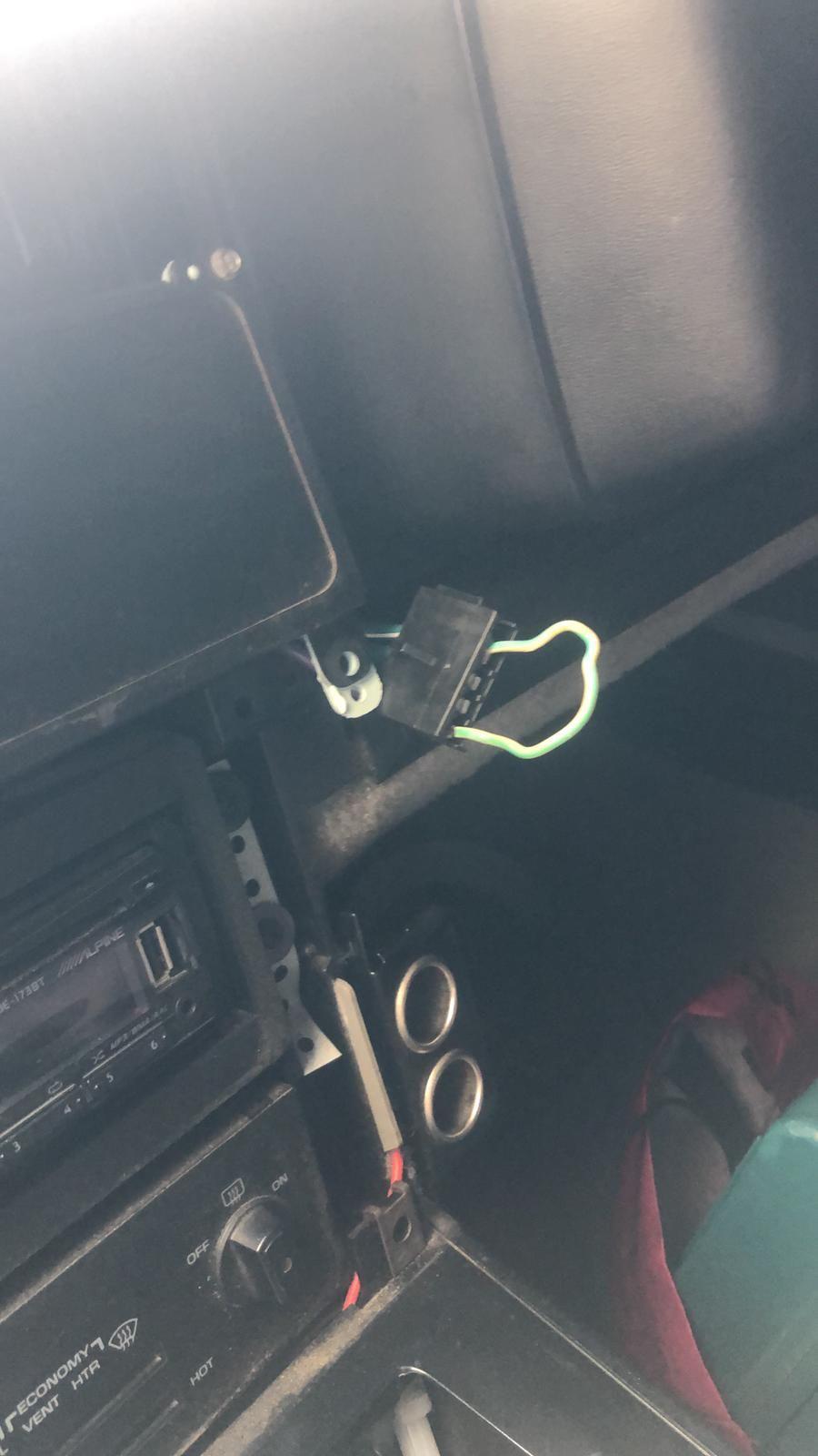

I believe its called the starter interrupt relay, my 85 does the same thing, I have to remove the DIC and move the wires behind it around. It's a pain especially since our cars don't have VATS.
Edit: Here's the starter circuit from the FSM, i have a manual so I jiggle the green wire going into the white relay just about in the middle. My car sat for 10 years so all the connectors are corroded and cause intermittent connections.

I had the same with my 1985.
Try to bypass.
