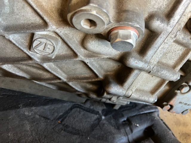

Originally Posted by Orion2011
I removed mine and plugged the hole. However I haven't put the car back together yet... LOL
I don't expect there to be a problem.
I did the same to my ZF6, no issues at all

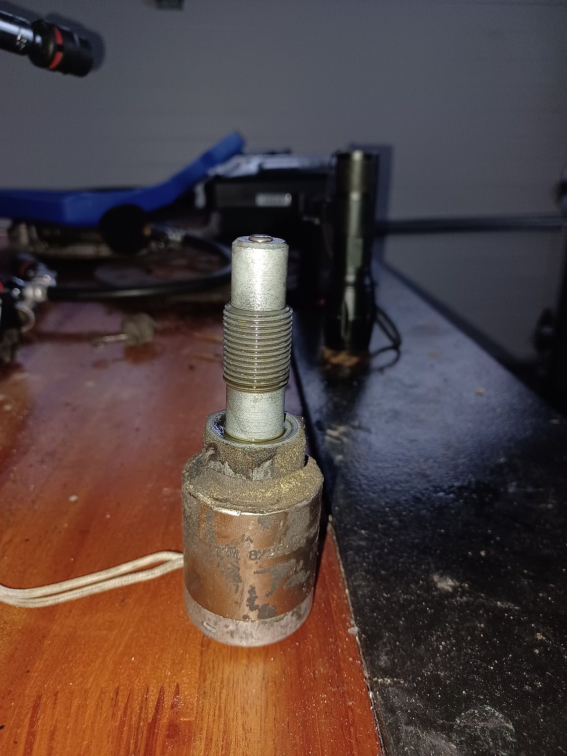

I've tried those and they aren't long enough to engage the threads in the trans. Threads are about an inch down inside case. 89 black lable.
Old Oct 19, 2023 | 05:10 PM
STK 327's Avatar
STK 327
Cruising
Joined: Jan 2011
Posts: 14
You can see on solenoid how far it goes until threads. Trans isn't here although has the same spacing until threads start.
You can see on solenoid how far it goes until threads start.
Old Oct 30, 2023 | 04:07 PM
STK 327's Avatar
STK 327
Cruising
Joined: Jan 2011
Posts: 14
Hi All, I wanted to close the loop on this one. So the solenoid has to be removed from the threaded bolt/plug on the end. Then I had to remove the actuator pin and spring inside the bolt/plug. A normal sized plug will then fit the top of the bolt/plug.
Old Oct 30, 2023 | 05:51 PM
AZSP33D's Avatar
AZSP33D
Joined: Jun 2020
Posts: 1,694
Likes: 728
From: Stay dangerous my friends
1992 — cant remember what the solenoid looks like but the simple aluminum oil pan plug worked perfect
