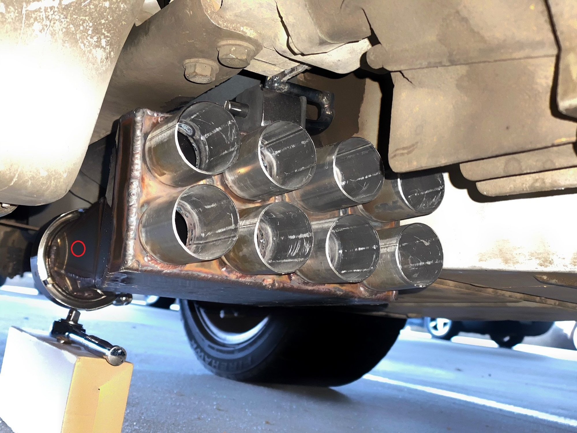

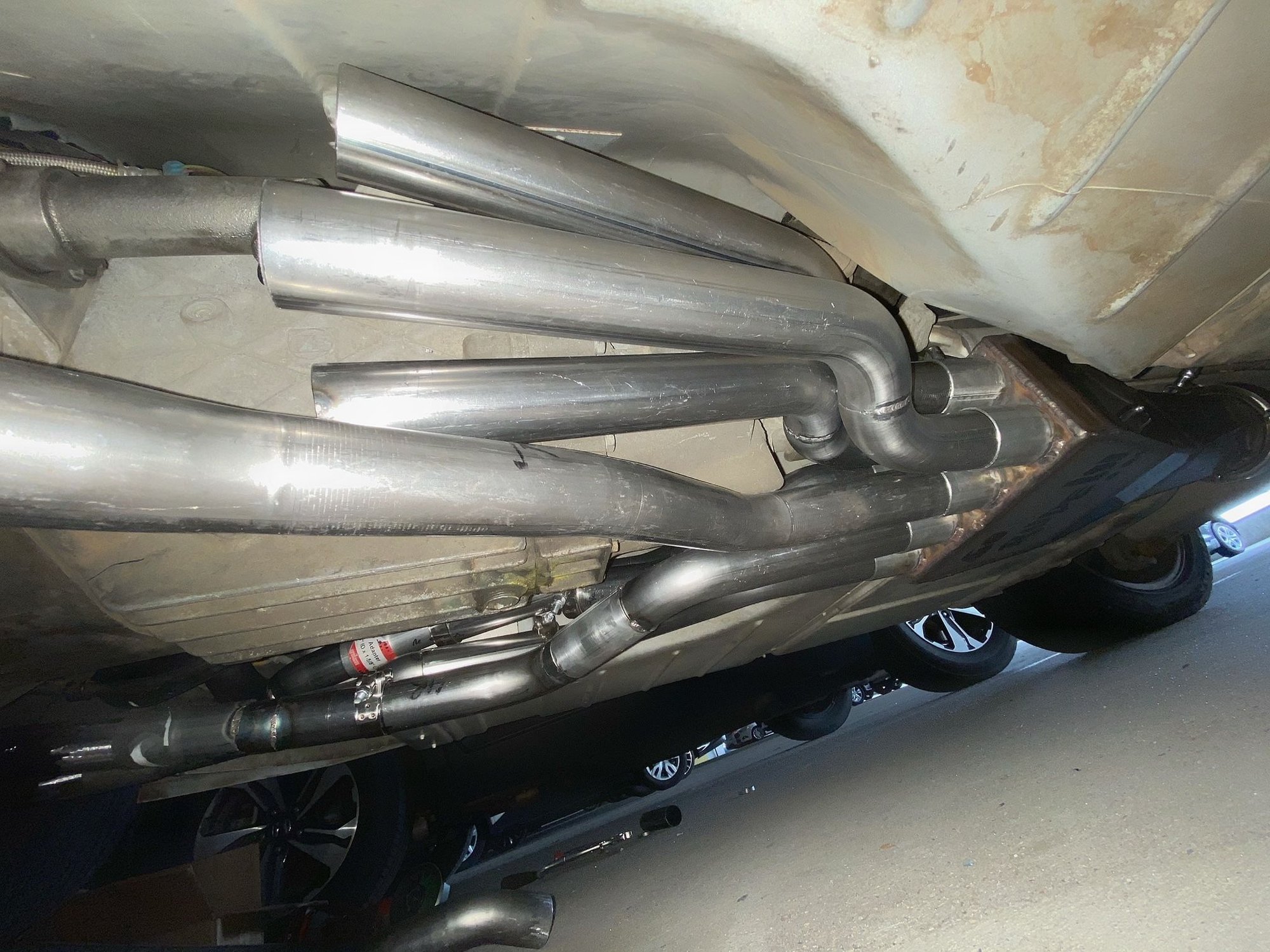

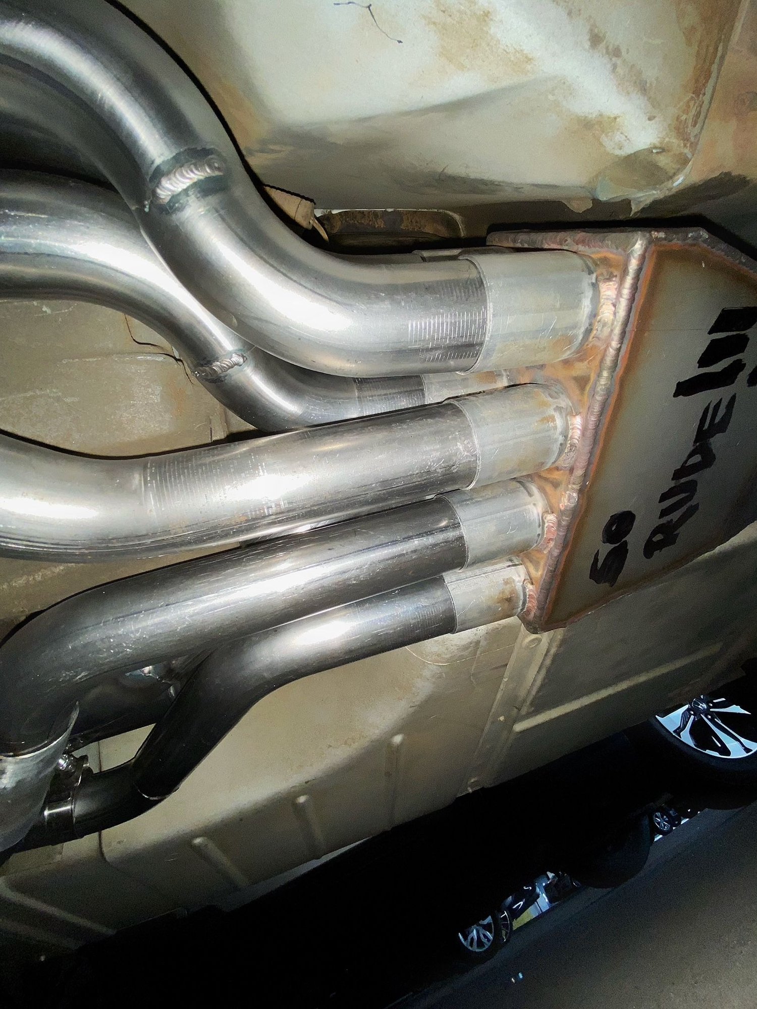

I am currently rebuilding my exhaust, see pictures below. The car is a 95, regular LT1 with 3 O2 sensors. I will have all 8 pipes merging in only one exit(collector - Designed this crazy different thing, whatever...), and that is where I will put the O2 sensor/sensors. All 3 sensors are equal, same part number and my question is:
Because it is the same part number and the same installation area, would any of you know if I would be able to use only one O2 sensor, and use the signal of this one sensor to feed the three ECU connectors? Sorry if this sounds dumb for some of you, i have already bought the sensors and extensions, it would only be fast and easier to use just one, I still need to weld the O2 threaded connectors.

..... Interesting little octopus you built there ! I'm just trying to imagine the scenario should you need to drop the exhaust to change the clutch or something .....

That is a good way to call it, octopus! I would need to drop it, but I would need to drop the OEM as well so I am not worried about it. I will do that soon as well, the clutch is 20+ years old, ~70k miles now, I want a better clutch.
