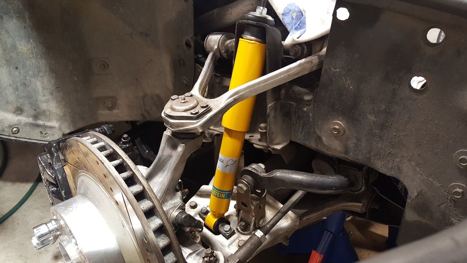

I definitely recommend Bilstein shock absorbers.
I switch to my 86 Z51 front and back with new Bilstins.
Rockauto was available at an affordable price.

I also agree with using Bilstein ! When I got my 89 it had 62,000 and the original Bilstein shocks in it, and I definitely noticed a difference for the better when I replaced them.
