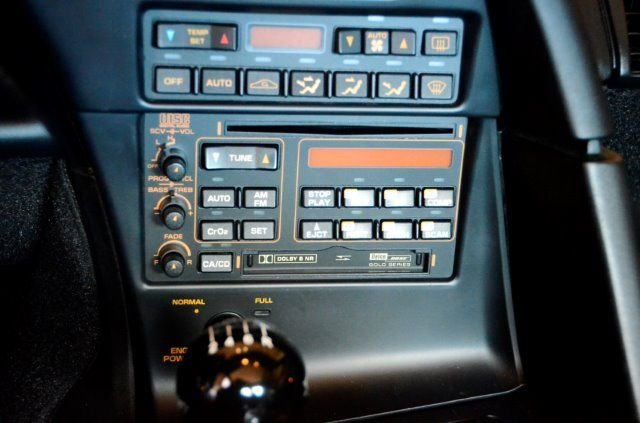

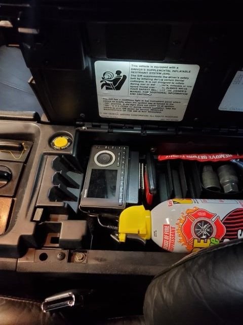

Contact Dr. Don, he is the man to repair any of our radios. I had a CD stuck in the radio and had buzzing and crackle/pops from the speakers. New front amps for the front speakers (they are cloth and will not wear out) and new speakers/amps for the rear (they are paper and do wear out). He refurbished my radio including putting an aux input on the cassette side with a long piece of cable so I could run it to my center console. Put a XM radio in the center console and the sound is crystal clear and clean. Awesome sound from the stock looking set up. http://www.doctordons.com/

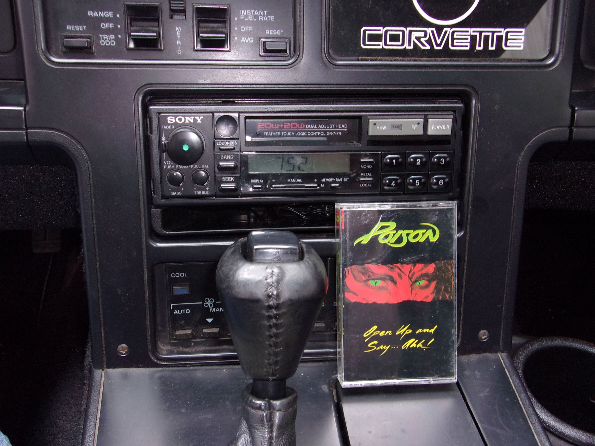

I replaced the entire factory Bose system in my 89 convertible with new speakers and a period correct NOS Sony tape deck for ~$350.
