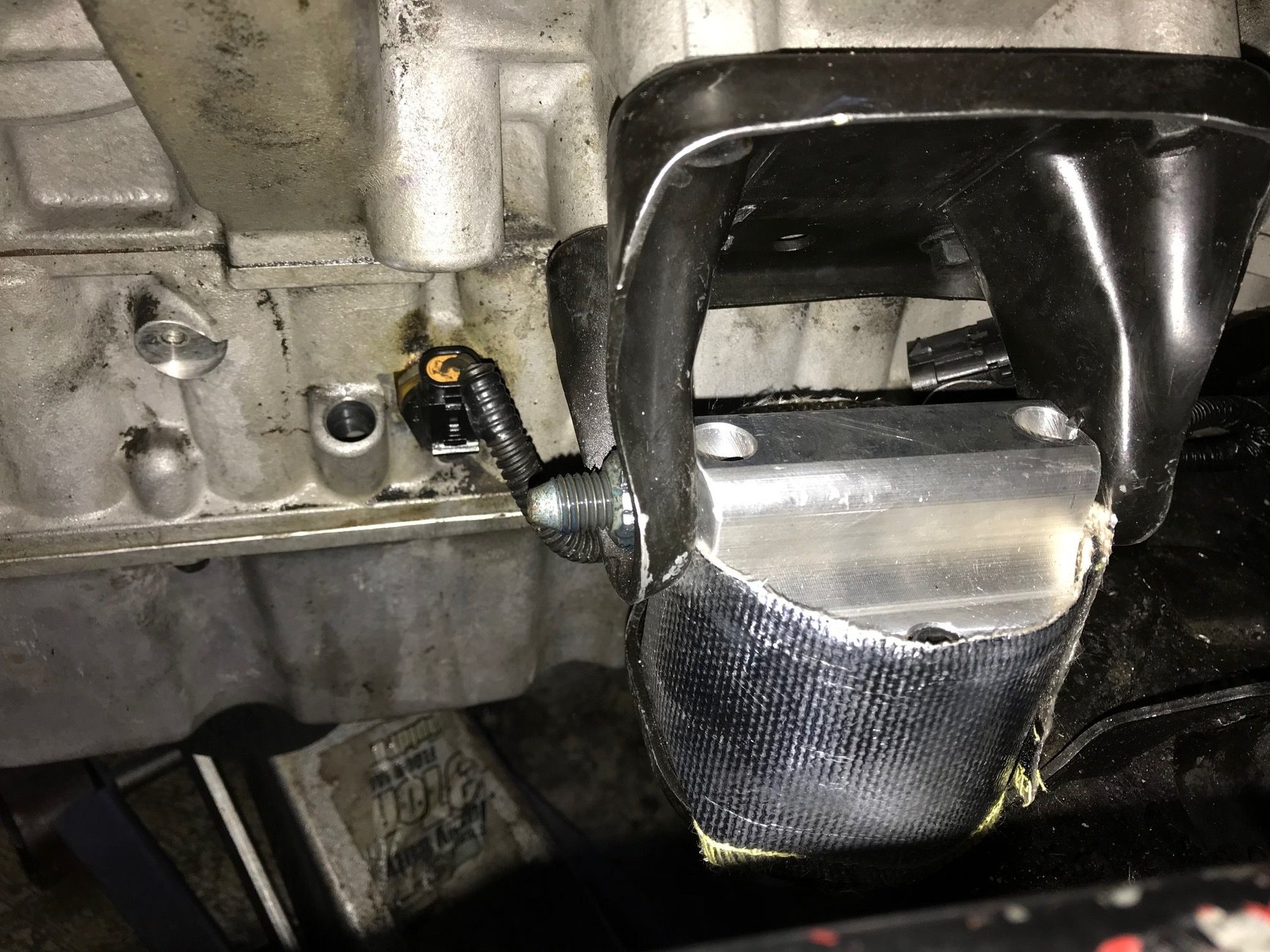

I’ve suspected an issue with mine, the car has felt ok under power, other than a clunk sound that I couldn’t pinpoint in the driveline when first applying a lot of torque... new or recent, u joints, suspension, brakes. I’ve had a really nice set of Prothane aluminum/poly mounts on the shelf for 6 months and today got to it.
Once I pulled the heat wrap off the mounts it revealed a failure of the drivers side mount. The fiberglass wrap was wet perhaps with oil though none had permeated through the foil and it really didn’t feel too oily.
Here you go, busted LT1 mount and a side by side with the new Prothane mount. They came out and went in easy. Along the way I discovered my drivers side cat guts completely disintegrated. Never heard a sound from it! Just wanted to share because so often when LT1 engine mounts are mentioned it seems to be questioned and posed that they don’t go bad.

A pic of the Prothane’s installed
