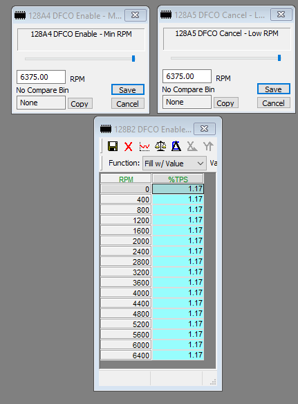

First off, I always recommend against pop and crackle tunes because you can easily scorch exhaust valves and drop seats, they sound cool but should only be used in moderation, only run that kind of tune if you do not care about your cats or no longer have them installed, also, expect a drop in city fuel economy if you drive in traffic.
To disable DFCO, set 128A4(DFCO Enable Min-RPM) and 128A5(DFCO Cancel- Low RPM)to a high value, typically 500RPM above your rev limiter will work fine, the first value defines what RPM you want DFCO to be triggered at 0%TPS, and the latter determines what RPM DFCO will be disabled once it is triggered. For an LS that would be sufficient as all enablers must be true, but if you are still having DFCO enable, you can change 128B2(DFCO Enable-Max TPS) to be 100% across the board. This will have you popping any time you lift off the throttle and for the entire duration until the engine returns to idle, if you want to have it do it every time you lift but only for a short duration you can set 128AB(DFCO Enable Delay Timer) to how long you want it to be plus about 1 second, so if you want it to pop for 3 seconds after lifting, set this parameter to 4 seconds. This is where my inexperience shows, I see that the XDF says "Timer to DFCO if CAT protect 0", I am not sure if that means you have to zero out the cat protection tables, or if this decreases/increases the delay until cat protect reaches 0.
You now have excess fuel in the cylinders and exhaust, to light it you will need to retard your timing. To do that, you will want to retard tables 1208A(Main Spark Advance) and 1217D(Extended Spark Advance), I don't have a bin file so I do not know what your base numbers are, and again am unfamiliar with these engines, but I would say do the majority of the retarding in the 25KPA column starting at about 1400RPM and up. Retard in 5* increments until it's close to what you want and then 2* for fine-tuning. You can also retard the 30KPA column and maybe even the 35KPA column, but you have to be careful to not go too far or you will negatively impact your acceleration, for the higher pressure columns, focus around the higher RPMs and leave the area around idle as it is.

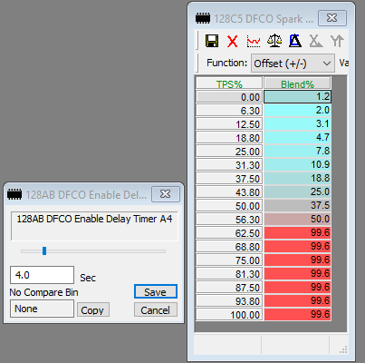

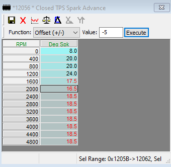

Here are some snapshots with what seem like reasonable numbers, but again, no real-world experience with the LTs.
How to disable DFCO:
Notice the maxed out enablers and disabler, this ensures that the ECM never commands DFCO and always commands DFCO disable.
This is basically 15* retarded, for a larger effect that slowly went away you could heavily retard 3600RPM+ and then interpolate down to the base timing, either way, you will want this table and the base timing table to be as close as possible to prevent issues when transitioning between the two.
I set the DFCO enable delay to 4 seconds, on the right you can see the blend table, you would use that to sort out any surging or jerking that could occur from DFCO to normal operation.
And lastly, the base timing table(s), ideally the transitions would be much closer than 5-10* but that will take in-car driving experience to smooth out and get right, in some places you can get away with it, in other it'll leave you with a jerky mess and a bad headache.

Originally Posted by ThatOneKid
That answers that then, so as long as all the flags to disable Cat protect are satisfied, the delay timer will give you your pops for a bit and then switch to normal. Taking a deeper look at things, and anyone with experience with these engines please call me out if I am wrong, you may be able to get away with just changing the 12056(Closed TPS Spark Advance) to retard the timing, but I don't know the criteria required for the ECM to use that table. If it is as simple as TPS=0 and no Cat protect flag etc, then that would be the only table you needed to mess with to get some pops.
Thank you for taking the time to explain this at length and with screen grabs, I appreciate it.
