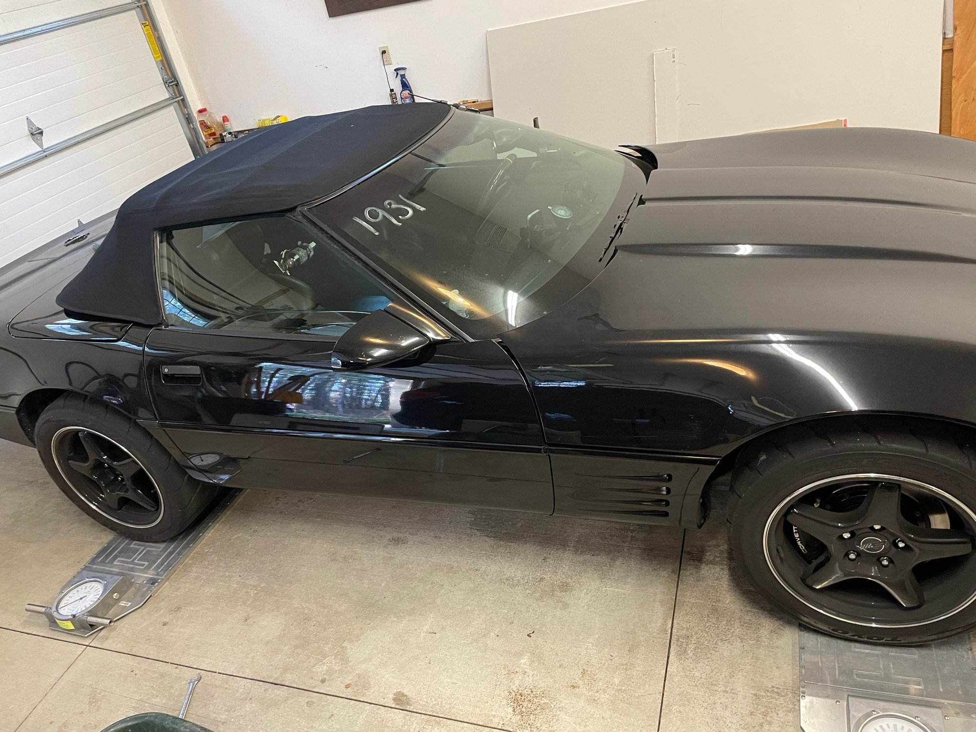

measured :
LF: 865
RF: 850
LR: 875
RR: 850

measured :
LF: 865
RF: 850
LR: 875
RR: 850
If you measure on an even level surface, the height to the fender lip, once corner balanced… this can be adjusted to where you want it… and also proper deck angle for aerodynamics, looks, and CG location is affected. Not exactly recommending or selling g you on that you get CO’s just trying to help with the thought process.
The cross weights look fine, very typical. They can be tweaked slightly but theres no CO need in that regard. If you break traction on the aRH side, raise the RR corner (tightening the rear adjusting bolt) or lower LR for the same effect, and longer bolts are available to lower the rear beyond the sock bolts capacity. Use a locknut if not cotter pinned.
Im not a drag racer but front ride height, spring rates, are often adjusted quite a bit, the CO’s on a C4 are more popular for drag racing than road racing. (Kerry Hitt won the Rolex GT roadrace championship in a C4 with fiberglass rear springs and claimed it was a performance advantage.)
