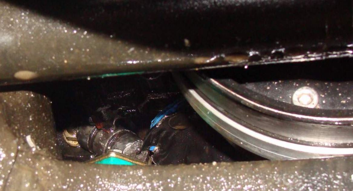

More pictures here
Engine still had stock 2-bolt block, stock crank, stock rods, stock pistons and stock bolts.
Post mortem analysis showed that everything started with connecting rod failure(s).
Caps and block showed sign of massive cap walk.
