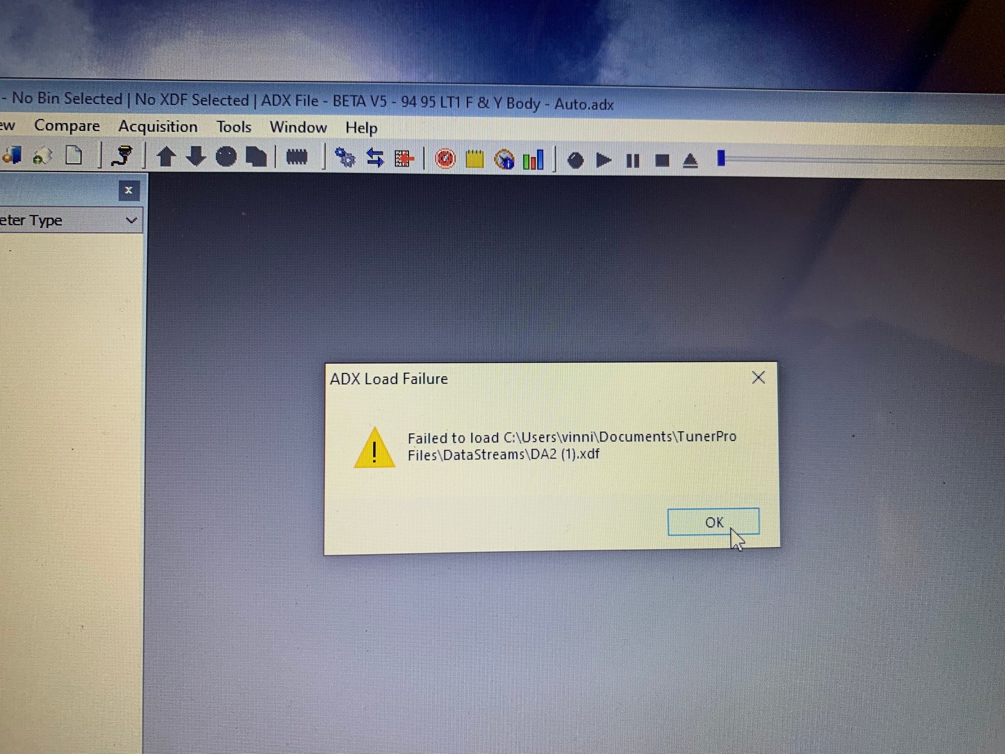

Trying to data log after burning a chip to send to my tuner. I’ve followed every set of directions I’ve come across online but miss XDF or DA2 files I get won’t open. And I also can’t seem to connect to the PCM. I have the correct ports and drivers, can verify the connection through TunerPro but still not getting anywhere.

Windows 10, but I’ve tried running in XP compatibility and as Administrator. Here are some screen shots of errors I’ve encountered. I’ve also tried on my desktop.

You need to download the DA2.ads file and convert it to an adx file with the import definition from ads tool under the Acquisition tab.
You only need the adx file for logging so you can ignore the xdf file. The xdf file is only used for viewing/editing the contents of the bin file.

DA2 has absolute garbage support on TunerPro (unfortunately). What you tried to do was load an editing definition for editing a BIN file (XDF) as a realtime datalogging definition (ADX). These are two completely and utterly different types of files.
As far as I know, DA2 only has an ADS (the older version of ADX used with ancient versions of TunerPro RT). This can be converted to ADX, but it also lacks the correct commands for Corvettes to silence the CCM and take over the bus as master (which is required for reliable datalogging). I've attached an ADX someone made that supposedly fixed these issues to my post. Enjoy.
