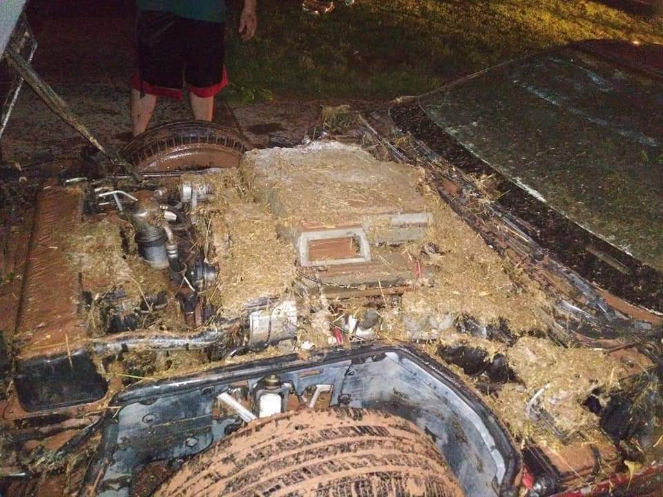

I have an 84 that was completely flooded back in August. The only real cost to me before the flood was $1200 and a lot of my own labor. Pulled the plugs and wires and found the engine is still good. 3 oil changes to get the water out of the engine. Exhaust is full of mud so we disconnected it. New plugs. Got it started and drove it just 1 block to see if there were any major problems. Luckily, nothing major except the driver's side headlight.
Next steps
I got the fuel pump and sending unit.
Pull and clean with electronic cleaner every fuse.
Will flush the tranny twice.
Flush the diff, brakes, coolant.
Probably 2 more oil changes within the first 500 miles.
I siphoned out 13 gallons of gas/water from the fuel tank. Would adding new fuel at this point be ok or should i get more gas cans and get everything out? I've never restored a flooded car so any tips and suggestions will be appreciated and welcome.

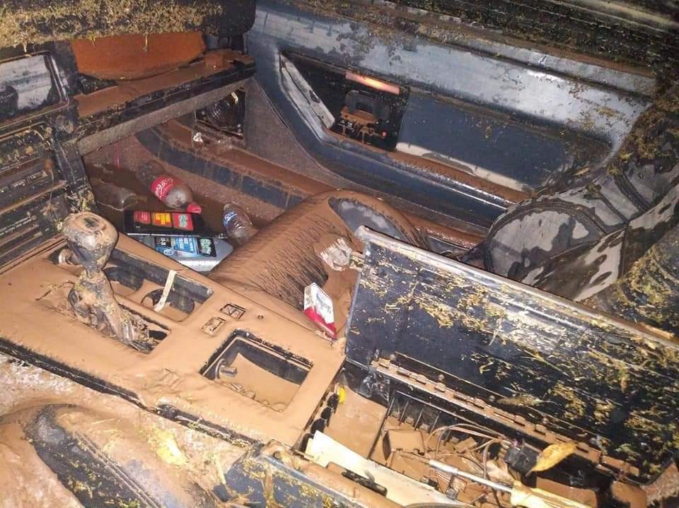

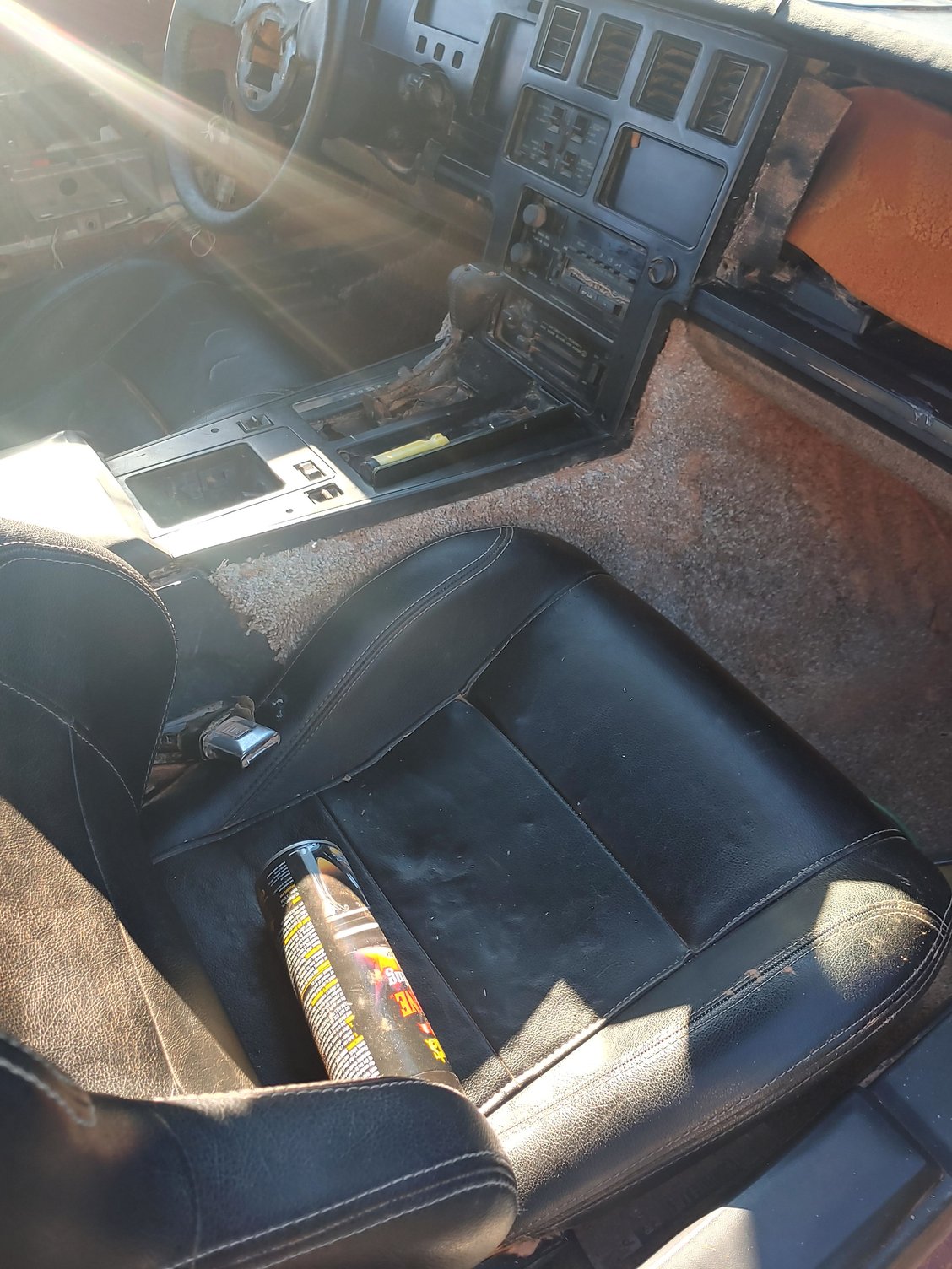

Here are some before and after photos of the major cleaning I had to do.

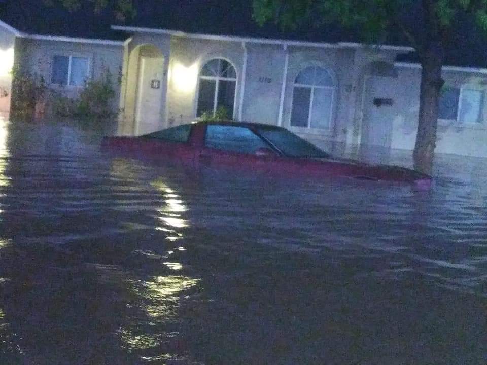

My house was uphill some. First thing I did when we fished it out of the water was disconnect the battery. Freshwater flood. All of the irrigation gutters were clogged and flooded my neighborhood pretty badly.
