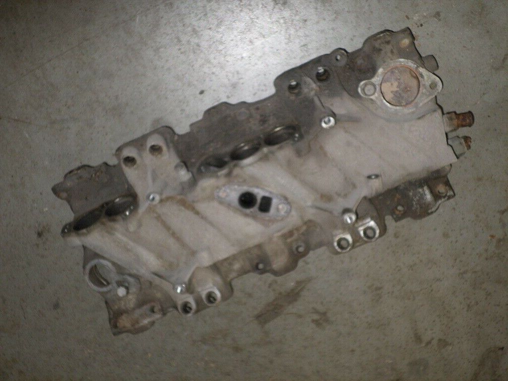

I took it apart and noticed alot of carbon buildup and when I did the open egr test while idling I had very little difference in idle. I am going to try and clean egr ports and areas because I know they are dirty. Here are my reference pics for the manifold channel, and then use some kind of brush to clean the tube openings.Hope to not remove the lower intake but I will if I have to I guess.

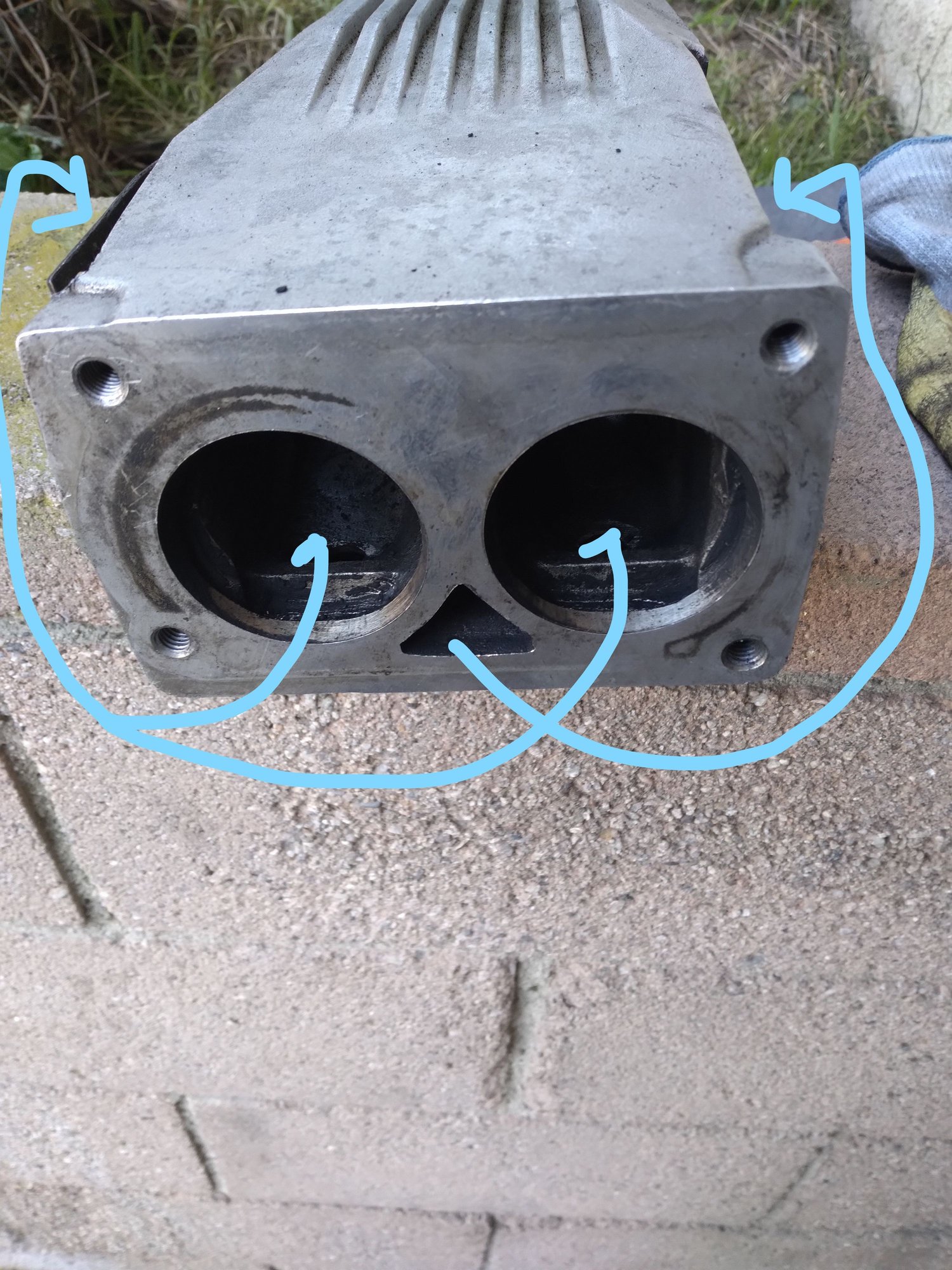

Yes the 85 only has 1 on the left bank. While I am posting today I took the plenum off for cleaning of the air passaged. I could not even see them but now they are open here is a pic. Harbour Freight has a great pipe cleaning kit for 7.00 or so.

I don't think it is that bad that it causes issues. The IAC might be different. Still, why not take it to a machine shop for a hot tank?
