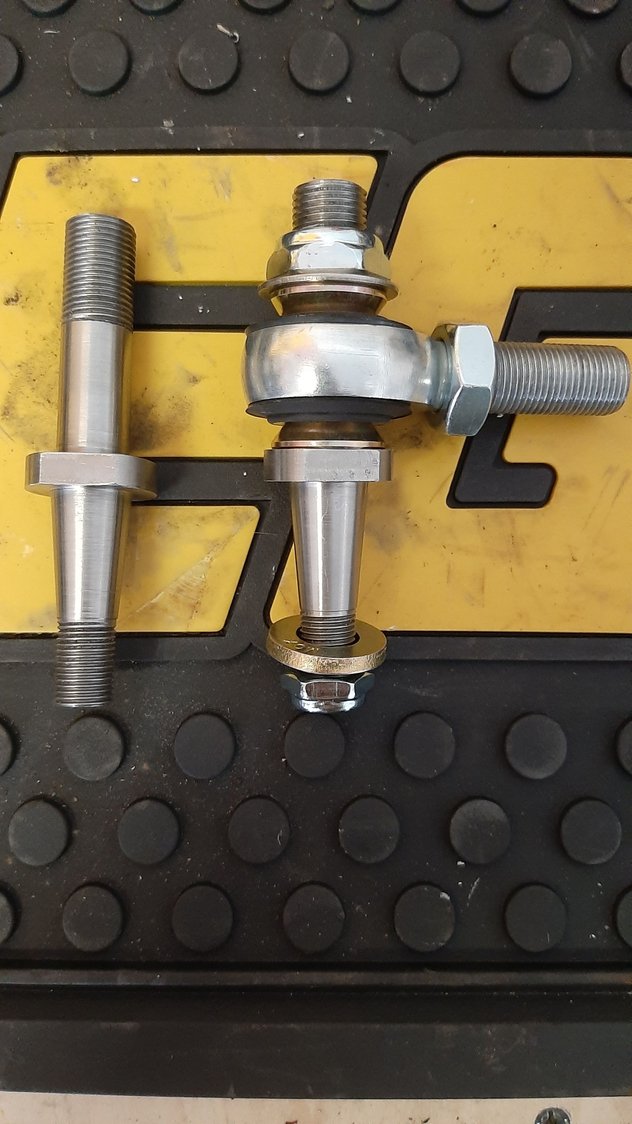

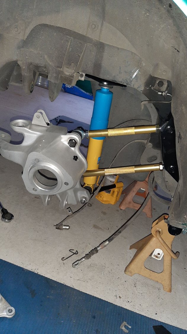

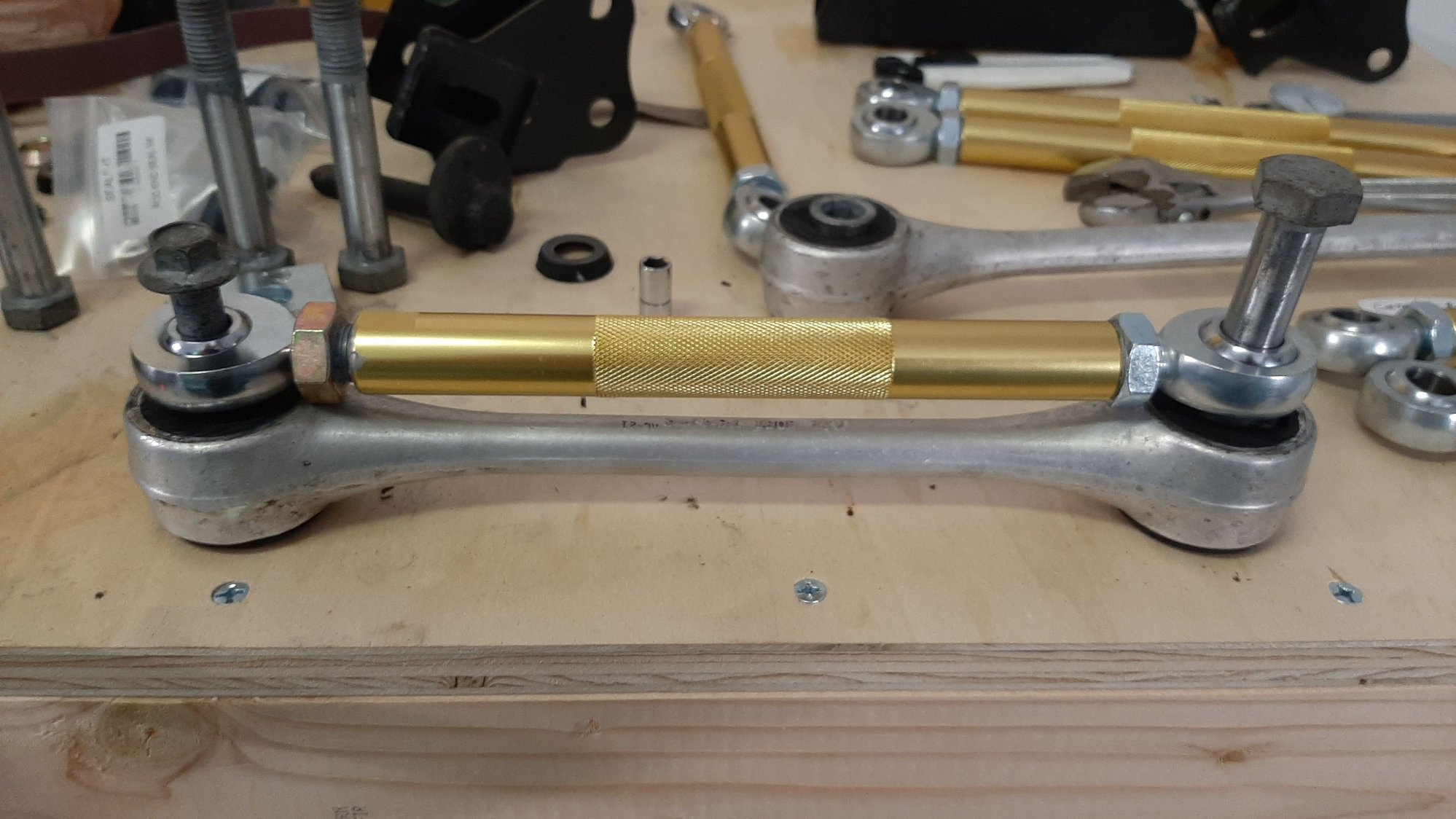

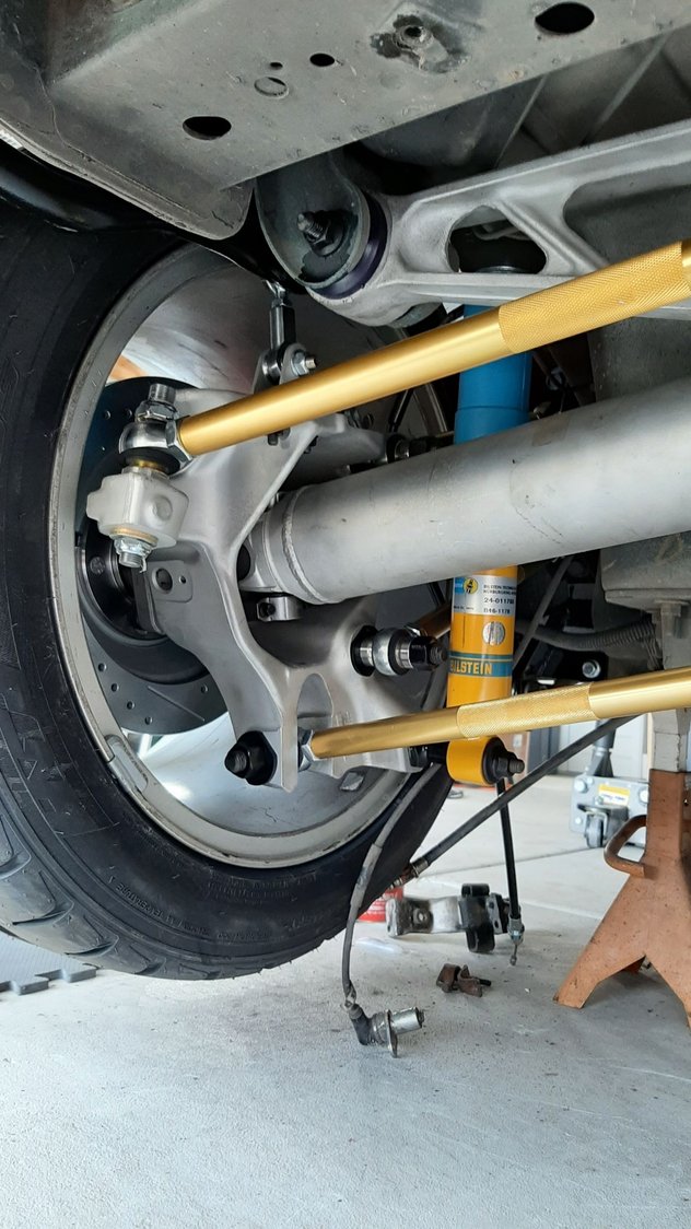

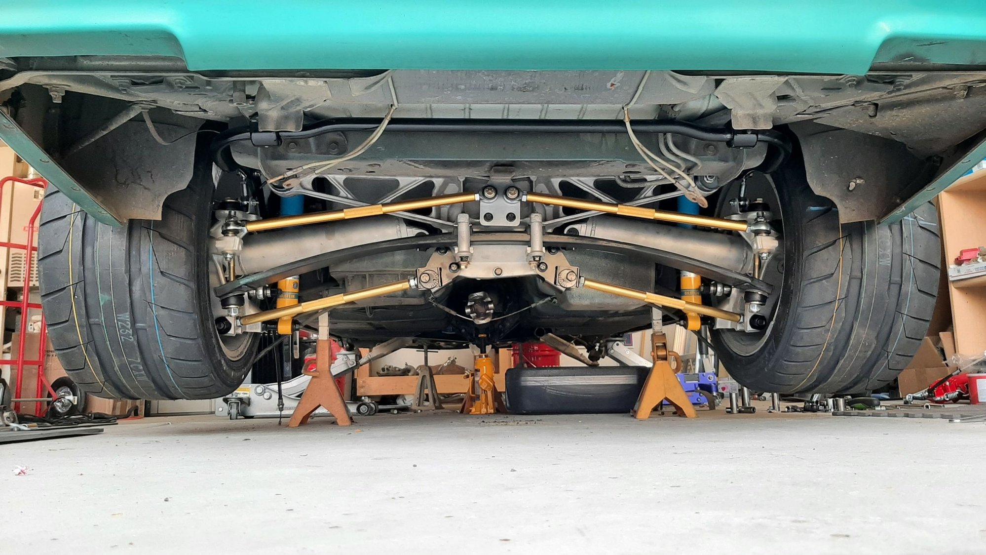

Seeing all of this reminds me why I went with heim joints with forged tubes and Global West Del-A-Lum bushings in front. No binding, no press work, just measured it well, had a local machinist make a couple of small parts for me and it all went right together. I was also amazed at how smoothly the suspension moves through travel - I tested it without the spring and shock attached - no more binding, nothing, just full travel through the arc.
Setting center to center distance
Test fit with the DRM brackets
Custom tie rod end replacements
going together
ready to set it down
