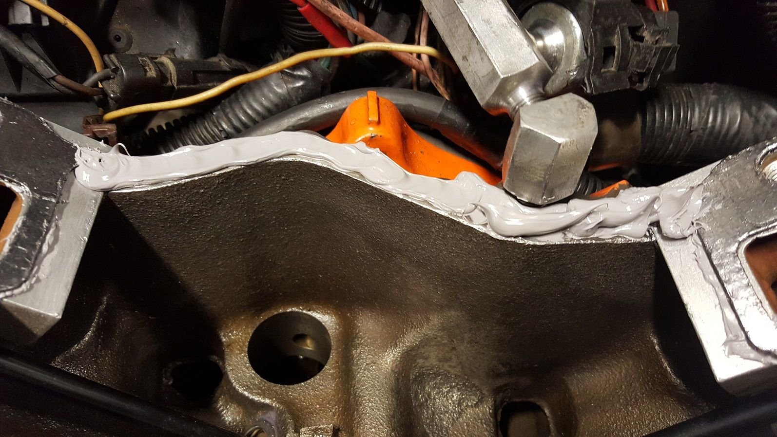

A couple notes, if your kit comes with the silicone China wall gaskets, toss them, they're absolutely worthless. A heavy bead of Right Stuff or Ultra Black is all you need.

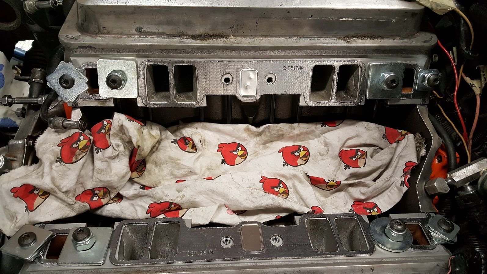

I like to chase the head threads with a tap first (3/8" x 16 tpi unless I remember wrong) and make sure that you don't leave any metal or sealer debris in the valley near the lifters. Dirt / sealer / gunk tend to collect near the lifters themselves and you don't want that to get into the engine internals somehow.

Thanks for the info, it really helps. I am going to use the Right Stuff on both the china walls, it is on order along with the gaskets. I do not have a torch to expand the metal around the bolts, but I will give them a good tap to try to loosen any gunk that may have formed around the threads. Hopefully that will prevent me from stripping the screw heads. I will keep you updated on the process when I start it in April. I still have two more car show left this spring.

Various tricks can hold the intake gaskets in place while you set the intake manifold into position. I bought some hardware store Allen-head set screws which are 3/8" x 16tpi thread (about 1" length) and use those sort of like studs (or alignment pegs) on the 4 corners of the heads front and back; that way the intake manifold slides into position over the gaskets and studs, and you can remove the studs afterward to put in the bolts. The GaskaCinch also works nicely to hold things in place - make sure to follow the instructions and let it dry first before sticking the gaskets into their positions.

And it will help keep the "Right Stuff" bead on the China walls from getting all over the place because you do not have to slide the intake around when making those final slight positioning adjustments.

Yes, that's exactly right, it will do all those things. Just remember that the allen set screws can't be sticking up too far from the head mounting face (maybe 1/2" max) since they are at different angles and the manifold won't go down over the pegs if they stick up too far. Try a test fit first to make sure that you can get the manifold down on the pegs safely and then back up off the motor, then you're free to do your RTV and gasket set into place.
If you get set screws that are long enough (1" should do it), when you loosen them up from the head the end will be high enough that you can just grab them with your fingers and pull them all the way out. Just be careful not to drop them into the valley or the intake port by accident. If that does happen it's not a tragedy, you can get them out using a trick I figured out once.
