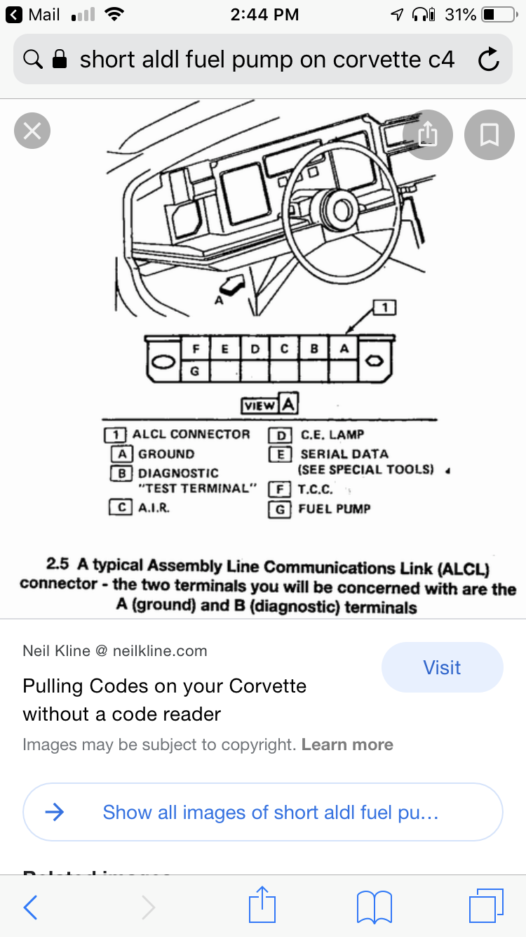

There is actually a way to trigger the pump to come on by shorting two pins in the aldl.
im not sure if you simply short a-g or if you have to send 12v from the battery to the pin g on your aldl to make the pump run.
you could try this (force pump to run and provide pressure continously)and then crank. if it starts immediately, then your issue is the rapid loss of pressure and waiting for the op to sense 5psi which then triggers the fuel pump to run again after the initial prime.
