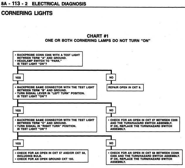

For some reason my passenger side cornering light is acting up. The drivers side works as intended. The bulb is good, the harness is fine and is getting a good ground, but I noticed with my power probe that the bottom lead on the bulb harness is pulsating with the flasher. Shouldn’t it be constant? Unsure what could cause this. Still not enough power to illuminate the bulb though.
The flasher relay seems to be fine since both sides technically work, just not the right side corner light. Fuses are good. Any ideas?
This is on a 1995 coupe. Thanks for the help.

The cornering light circuit is incredibly basic, so there's really not much that could be the culprit. Here's the circuit layout and flowchart.
