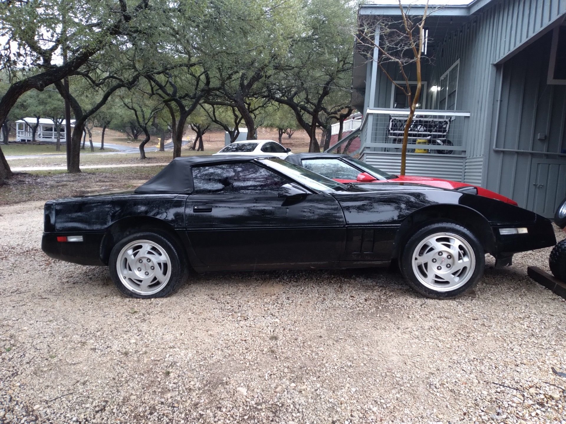

Got car from Texas no engine no trans
have 6.0 iron block 799 heads ls9 cam ar5 trans want to convert to manuel.
still worried about hood clearance shifter location
And the c beam adapter...

The hood clearance won't be an issue with a car intake manifold. You are going to have to figure out the c beam adapter and something for the shifter. The shifter will likely need to be offset towards the driver's side several inches. Depending on where the shifter lands in the tunnel, you may be able to get away with a custom offset shifter handle/rod.
What is the AR5 trans out of? Some of the AR5s from the Pontiac Solstice or Saturn Sky used a c-beam (torque arm) instead of a perpendicular crossmember. The tail shaft housings on those have two vertical pass through holes very similar to c4 setups. Seems like one of those wouldn't be too tough. Looks like a fairly expensive adapter plate has to be used to mate the AR5 to a bellhousing that will work with an LS clutch setup. And the AR5 isn't all that stout. 260tq rating.
My 6.0 LS swap 84 has a TKO 600 w/ LS7 flywheel/clutch and a Tilton 6000 throw out bearing. The c beam adapter is a Silver Sport Transmision piece.
