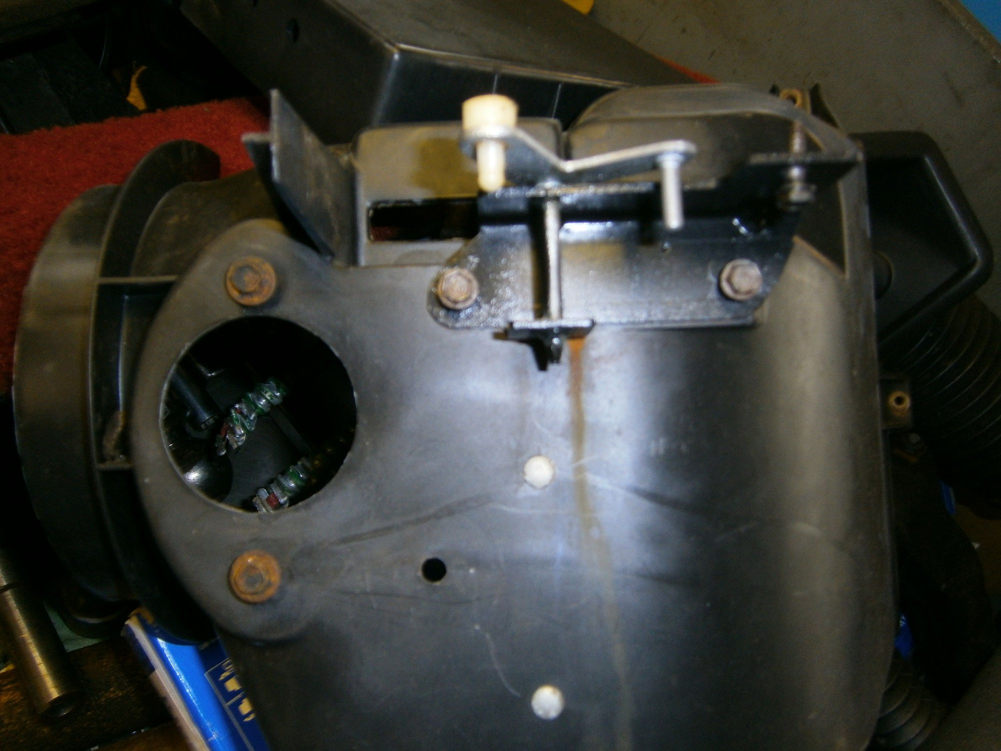

On my '84 the bellcrank for the blend door was frozen in the halfway position. You'll have to at least pull out the hush panel on the passenger side to get to it. A little oil and some wiggling got it freed up.
Pic is the front of the heater box out of the car. Don't expect your bellcrank to be painted. I had mine out so I cleaned it up. Cable is attached to the silver pin. The pushrod to the blend door is attached to the white clip.

I did have some water intrusion so its very possible that the bellcrank is rusted. Does the carpet hush have to come out or just the plastic panel to get access? Looks like its going to be fun.
Could be the cable too but it did work before its 8 year sitting nap....poor thing I just haven't had the time to mess with it.
Thank you both, I will let you know tomorrow what I find.

My cable and bracket were completely detached from the plastic housing. It looks like the little bar that connects the bellcrank to the heater door is missing, and I can’t see much with the heater box still in the car. Is there any way to get at it without removing the box?
Old Oct 19, 2023 | 07:20 AM
Kilobuck84's Avatar
Kilobuck84
Joined: Nov 2021
Posts: 1,737
Likes: 386
From: People's Republic of Nueva York
You could try fishing around in the slot with a magnet. If the rod is still attached it would probably be held up somewhat by the attachment to the blend door. If that fails you're probably going to have to pull the inner box. I'll try to get you a pic when I get to the car later.
