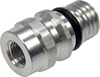

There are actually tools available that allow you to replace the schrader valve without losing all the refrigerant.
https://www.amazon.ca/dp/B0015KH93K/ref=cm_sw_r_cp_apa_glc_i_5QSYY66QPN4QKARP091P?_encoding=UTF8&psc=1 https://www.amazon.ca/dp/B0015KH93K/ref=cm_sw_r_cp_apa_glc_i_5QSYY66QPN4QKARP091P?_encoding=UTF8&psc=1
https://www.amazon.ca/dp/B0015KH93K/...ing=UTF8&psc=1
The tool you are referring to appears to only replace the valve core, not the actual valve itself.
