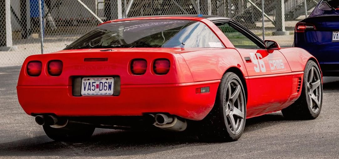

You can absolutely run 11" wheels up front if you get the offset correct. People seem to run 36mm front and rear on the early C4s with 315 tires. I would have thought 32mm would be correct based on the 18mm difference in factory wheel offsets for early 9.5 and later 9.5 wheels. But not having tried this on an early car myself, I can only go by what other people post they are doing. Spacers are fine if you get wheels with 50mm offset. You'll need longer wheel studs to safely run thick enough spacers.
As for whether 11" wheels are a performance upgrade up front, they absolutely are. There is no case with a street car on street tires where wider wheels/tires don't give more grip if all else remains equal. GM's decision to stick with 9.5" wheels up front had absolutely nothing to do with that being the best case for ultimate performance. Nobody - and I really mean nobody - who races Corvettes in any competitive environment where non-stock widths are allowed sticks with 9.5" wheels and 275 tires. That would be silly.
I also agree about larger diameter wheels on C4s not looking correct. The C4 is a teensy car compared to modern goliaths. The problem is there are very few decent street tires left in 17" diameters and none in wider-than-stock widths, and only the Hoosier A7 and Toyo r888r in race tires (which are street legal but you won't want to use them for that). 18s offer more choices in 275/35, 285/35, and 295/35 sizes for street tires; and several options 315/30/18 competition street-legal tires. They don't look too silly. The main thing is to keep the outside tire diameters close to stock. 19s are starting to get into silly territory. This is my car on 18x11 and 315/30/18 tires front and rear:

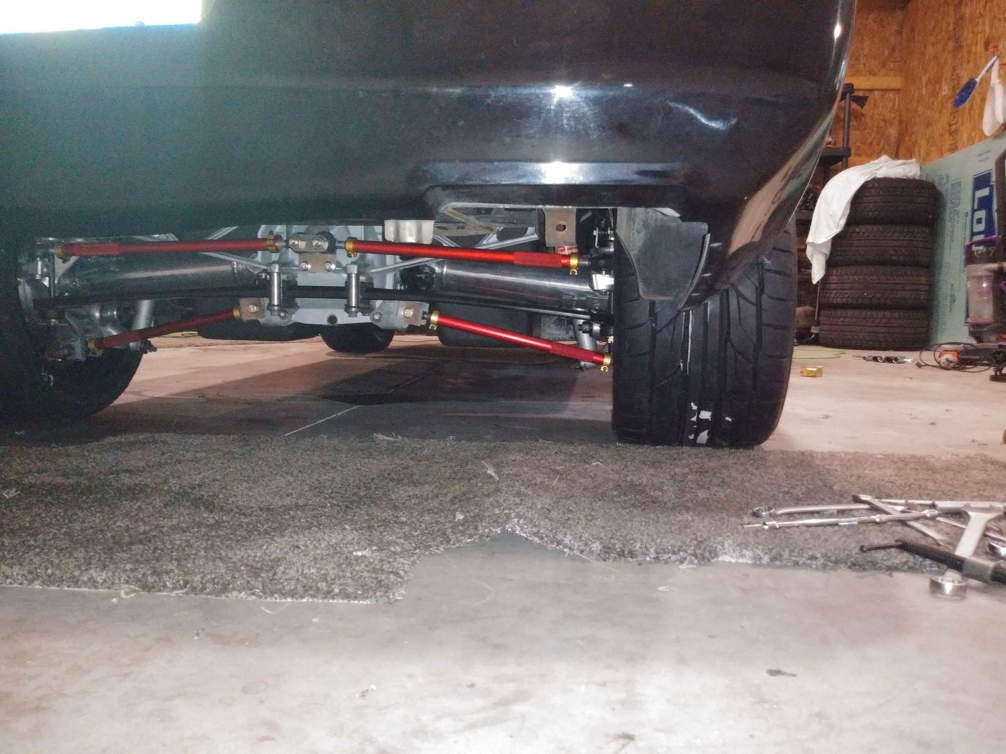

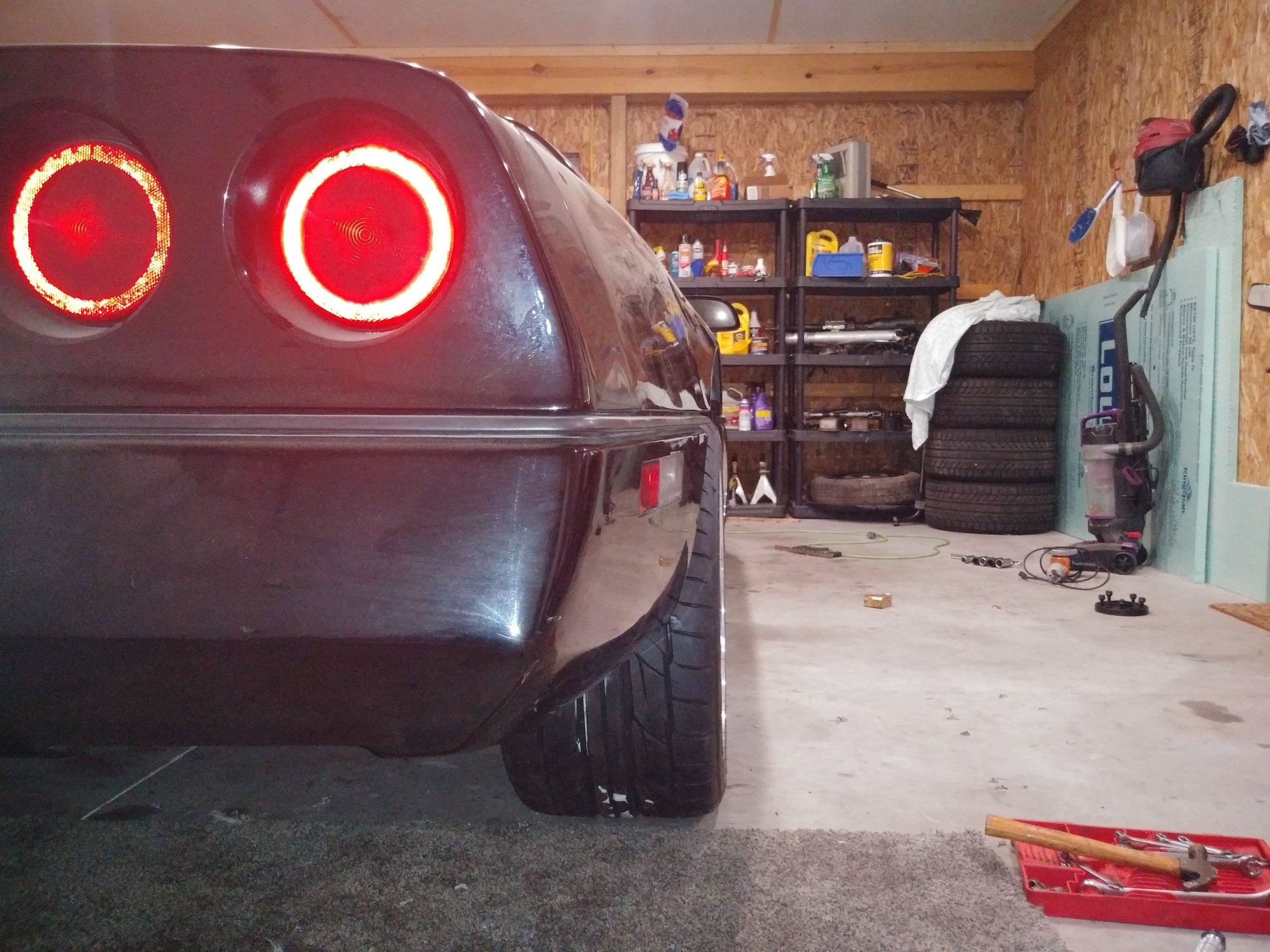

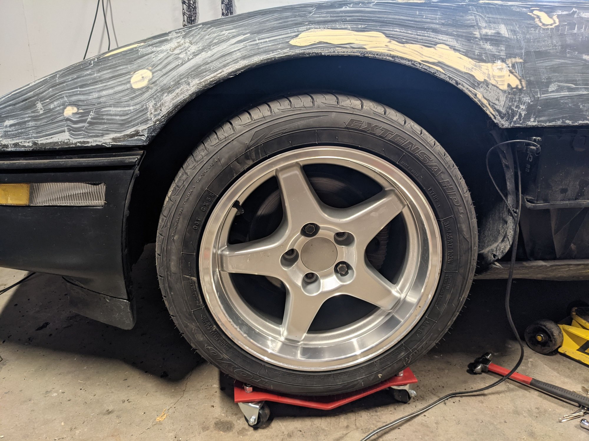

Finally had some time to test out fitment with some test spacers. Had trouble with rear studs, so did the front for now. Stuck a 10mm spacer in front seems to clear lock to lock looks a little tight but it really isn't much more than stock.
Clearance in the front with steering full right
Clearance in the back with steering full left
