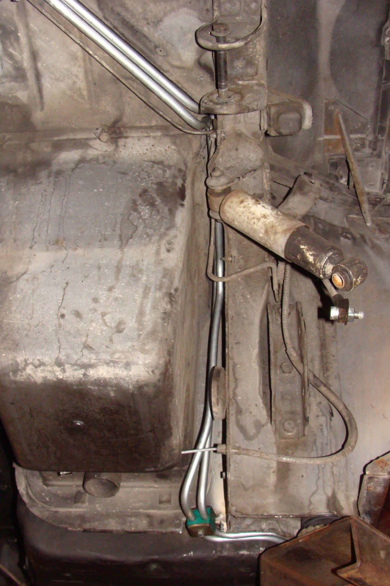

I can definitely see doing something like this. I'd want the PTFE sections to be short enough to be changed out without dropping the bumper but it looks like a good solution

Yeah, I've used nylon for repair for a few years now. Advance Auto carries S.U.R.&R. products, they make all kinds of fuel line repair parts. Sometimes I'll do away with the bolt on fuel filters and instead use quick connect type fuel filter. I made a setup to press quick connects onto nylon lines, use use a caulk gun and wooden clamps to hold the line.

My 88 project was frame up, all custom lines for everything.
I just gave my .02 in another forum last week about fuel lines.
My entire car (feed and return) are 3/8 aluminum fuel line with 37 degree (AN) flares and Parker push lok fittings. Works perfect and its easy to do. The aluminum line you can bend with your hands and never kink it - its that nice. All fairly cheap $ wise as well.
