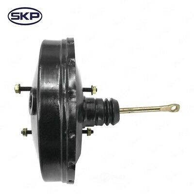

I am talking about one of these cheapies. At the time I think I paid $85 or so on ebay. It obviosly can't be as good as the oem sized one but it works well in my setup and I don't know what a stock one feels like anyway.
Just eyeballing it, that looks about the same size overall as my girlock unit currently in the car. Gotta be better than what I've got now and if it fits it ships so... I'm pretty sold.

Figured I'd update this. Once I got the adjuster figured out on the master it drives great. The booster is still a little over boosted, as in free travel is very light but the brakes still have good feedback. I'm pretty sure the booster/master was foobar for a long time because this brakes surprisingly well and better than since I've had it over the last 15 or so years. It hasn't left me wanting to do a brake upgrade like I thought I did last year when it was difficult to stop with the extra power... ie driving faster lol. I'll link the unit I bought here. No complaints with it. It fit fine except I had to ding one small spot to clear the throttle cable and that was only because it was close... it really didn't need it. I will reccoment getting or building a plunger adjustment tool however.
