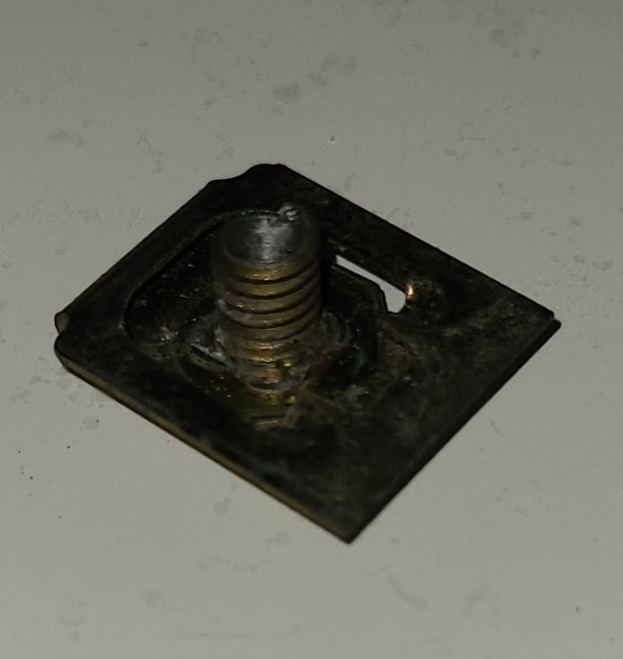

While looking in the area of the latches, I noticed behimd the cruise control module, one of the nuts that holds the ecms bracket was gone. So, off to hardware store.

Well, I need more hardware. This snapped. Wonder how easy it is to find it.

Well, update. It was the ecm bracket. Not having the third nut holding the ecm in the bracket was causing a squeaking noise resonate into the car..
