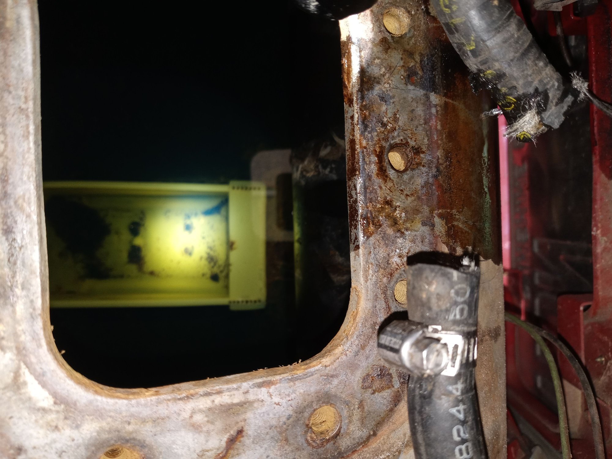

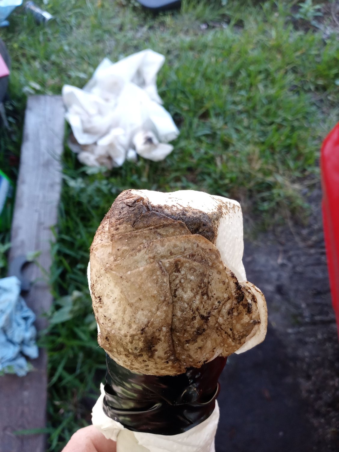

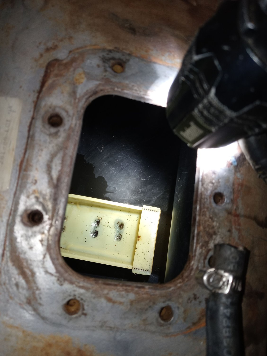

I literally just did this on my 1987 this past weekend. There was about 3 oz of rust and sediment in the bottom of the tank from a previously rusted sending unit prior to my purchase and after previous owner put in a new one and pump. I used a turbo pump (as seen on tv) and that ot most of the gas and a lot of the rust flakes out. I then stuck my arm (getting it almost stuck several times) through the filler neck and removed most of the rust with a roll and a half of paper towels. Once all the fuel was out and the tank was dry, I used a piece of pvc pipe and paper towels taped to the end to wipe out what I could not reach. Finaly I shpop vacc'd the last little bit. It took about an hour and a half but fixed my fueling problem. Fuel sending unit came out in about 20 min. I will try and upload pics. The last pic is before the shop vac. It came out almost perfect. I was losing fuel pressure as I got into upper rpms. it runs almost perfect now. I will be changing the fuel filter soon and already have new injectors I will be replacing eventually. This solved 98% of my issues though, including my hard to set idle.
