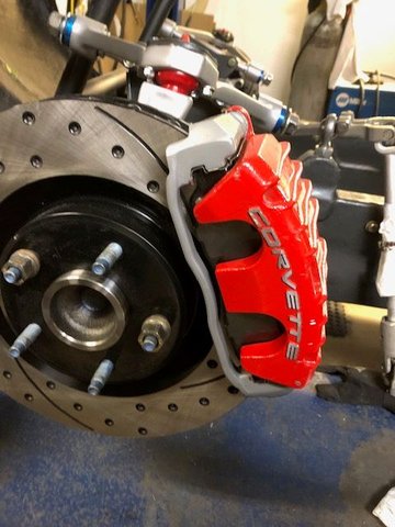

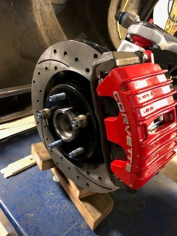

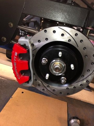

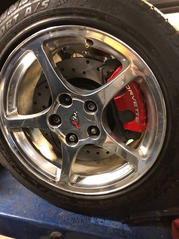

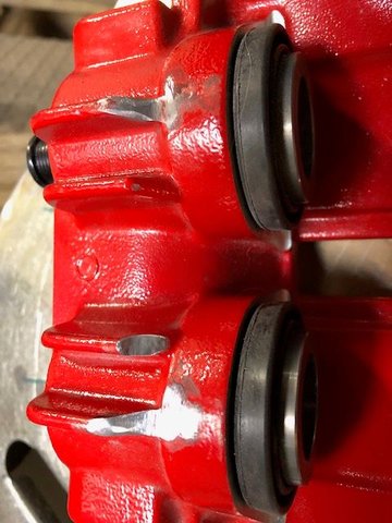

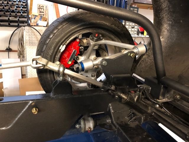

You can use the C5 / C6 base calipers, rotors and caliper brackets with adapter kit. Not a difficult upgrade
I haven't upgraded my C4 yet, but i have installed front & rear on my '37 Chevy Coupe build. I installed new C6 new calipers, they are a little thicker in a few areas,,, $250 a pair. Wilwood Dimpled & Slotted Rotors $100 each.
I'm also using C5 thin spoke wheels (now powder coated black), 17 front 18 rear, Wheel Clearance is tight !! I haven't had time to check to see if my C4 ZR1 wheels will clear the calipers.
Front wheels definitely need to be 17 inch. if you upgrade the rears you will need to complete some clearance on the rear calipers.
Let me know if you would like additional photos,
Michael..
