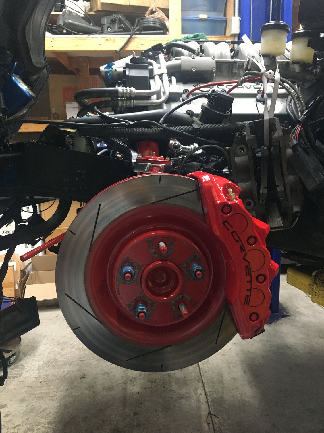

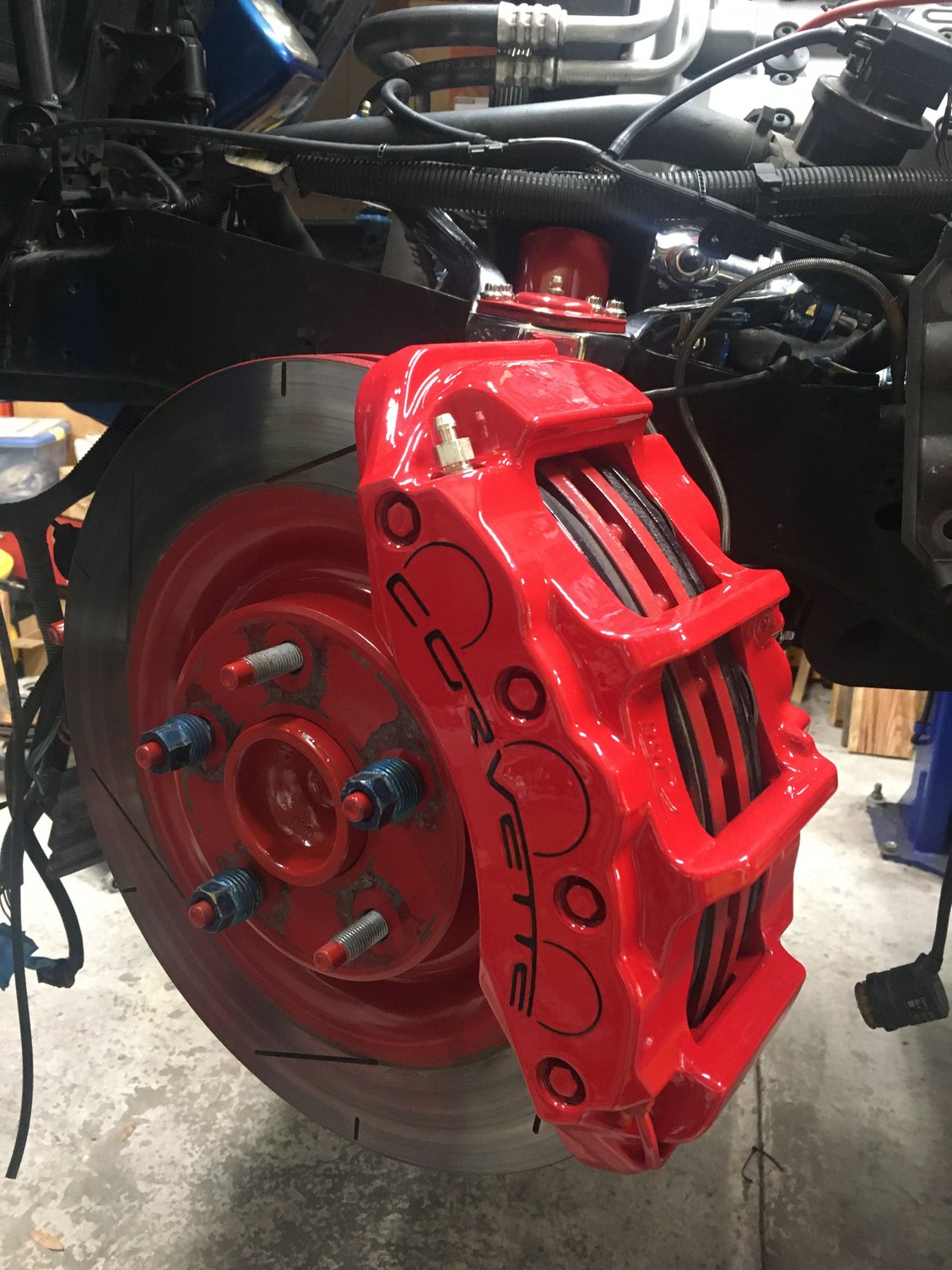

Originally Posted by dt25
Pads were the culprit.
C6 brakes are in the future.
z51 caliper on top of the c6z caliper
c6z caliper and rotor. will need 18" wheels
c6zr1 calipers are even bigger
