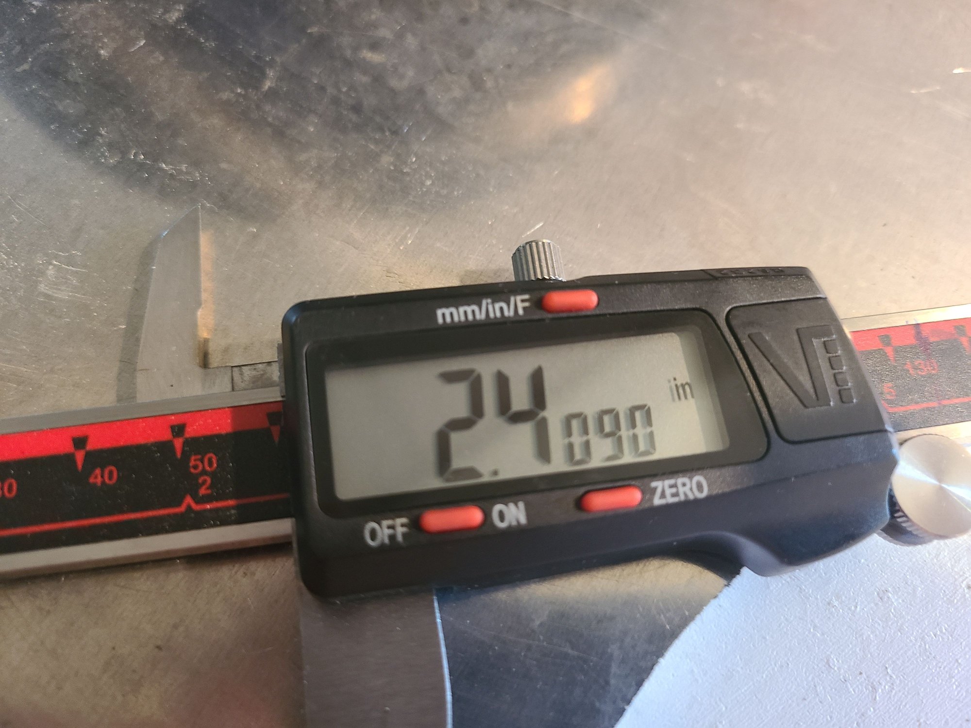

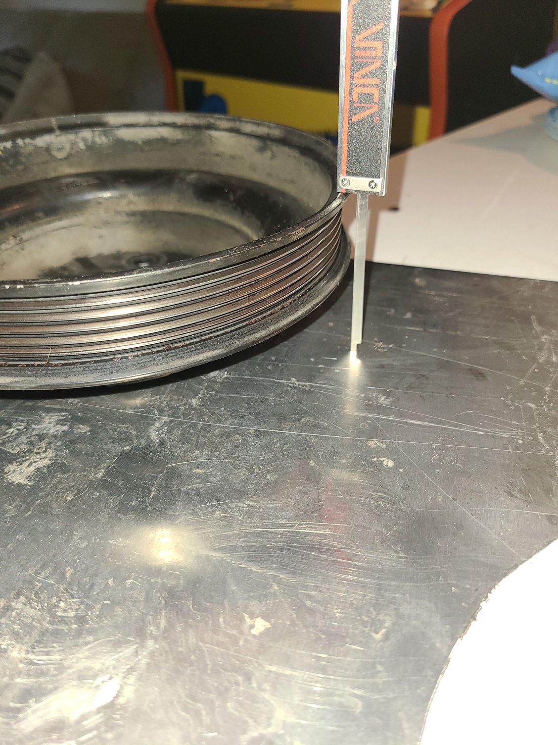

Posts: 6,940
Likes: 1,490
From: New Jersey
I get 2.4 on mine. The step on the back that sets in the balancer is recessed into a hole in the aluminum plate so the measuring surface is flat against the back of the hub.

84 4+3's Avatar
84 4+3
Joined: Aug 2017
Posts: 6,940
Likes: 1,490
From: New Jersey
Originally Posted by WVZR-1
Turning it 'over' and measuring through one of the 3 mounting holes is what I had in mind!!
same difference lol... it is presently 3 am for me as I'm running nights so it's the best I could do lol.
