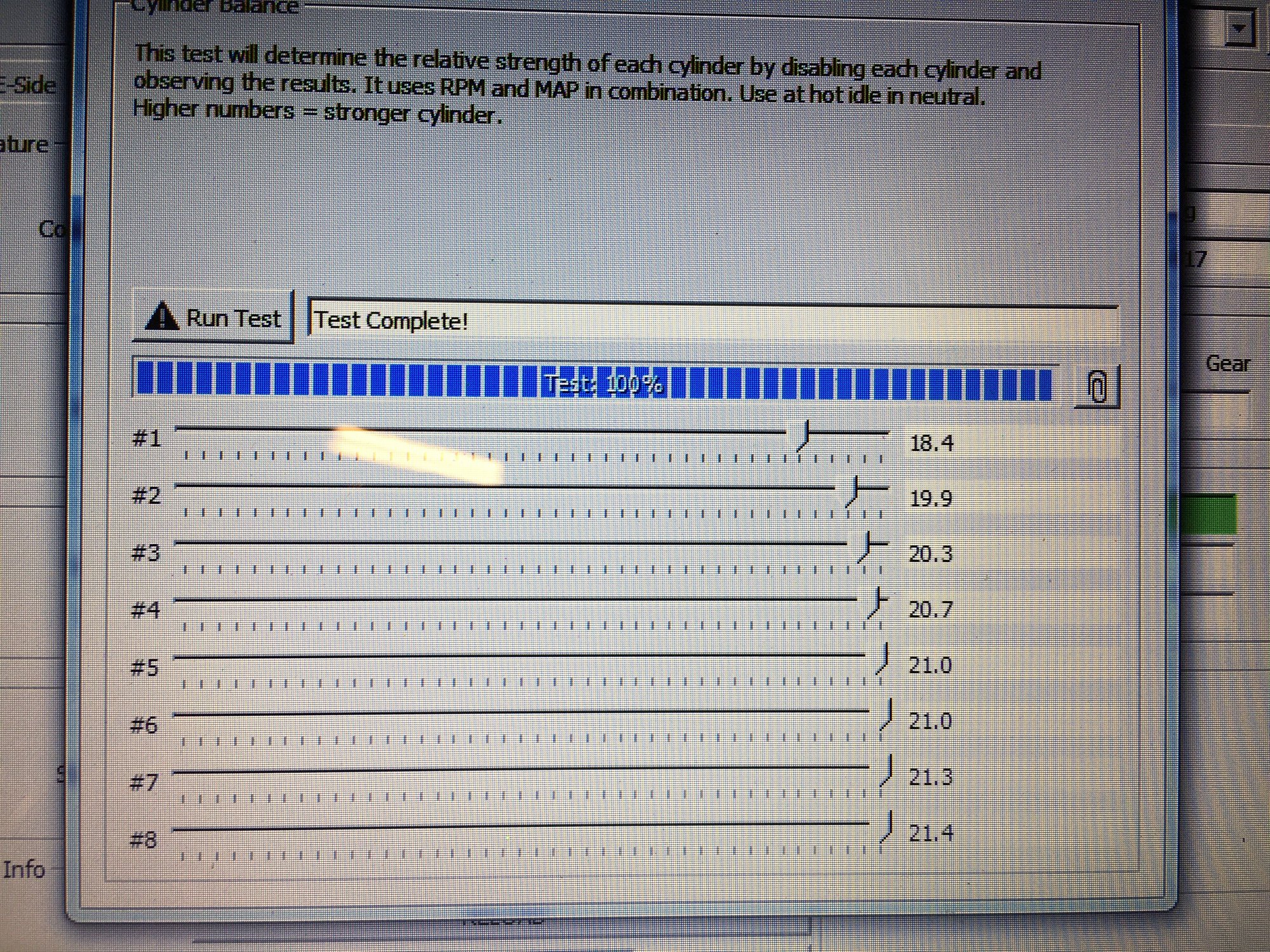

Cylinder efficiency comparison looks better, what say you? Still a little something going on towards the front. If the upcoming intake gasket change doesn’t improve it, I suppose it’s just engine wear. Valves leaking a tad or maybe a bit of blow by. Although the cranking compression was really even across all cylinders. We’ll see...

Looks roughly like my engine. If the intake thing doesn't fix it it makes me wonder if there's something fundamentally wrong with EEHack's test. Or maybe just all stock LT1 manifolds have garbage balance.
Best of luck with the gasket swap!

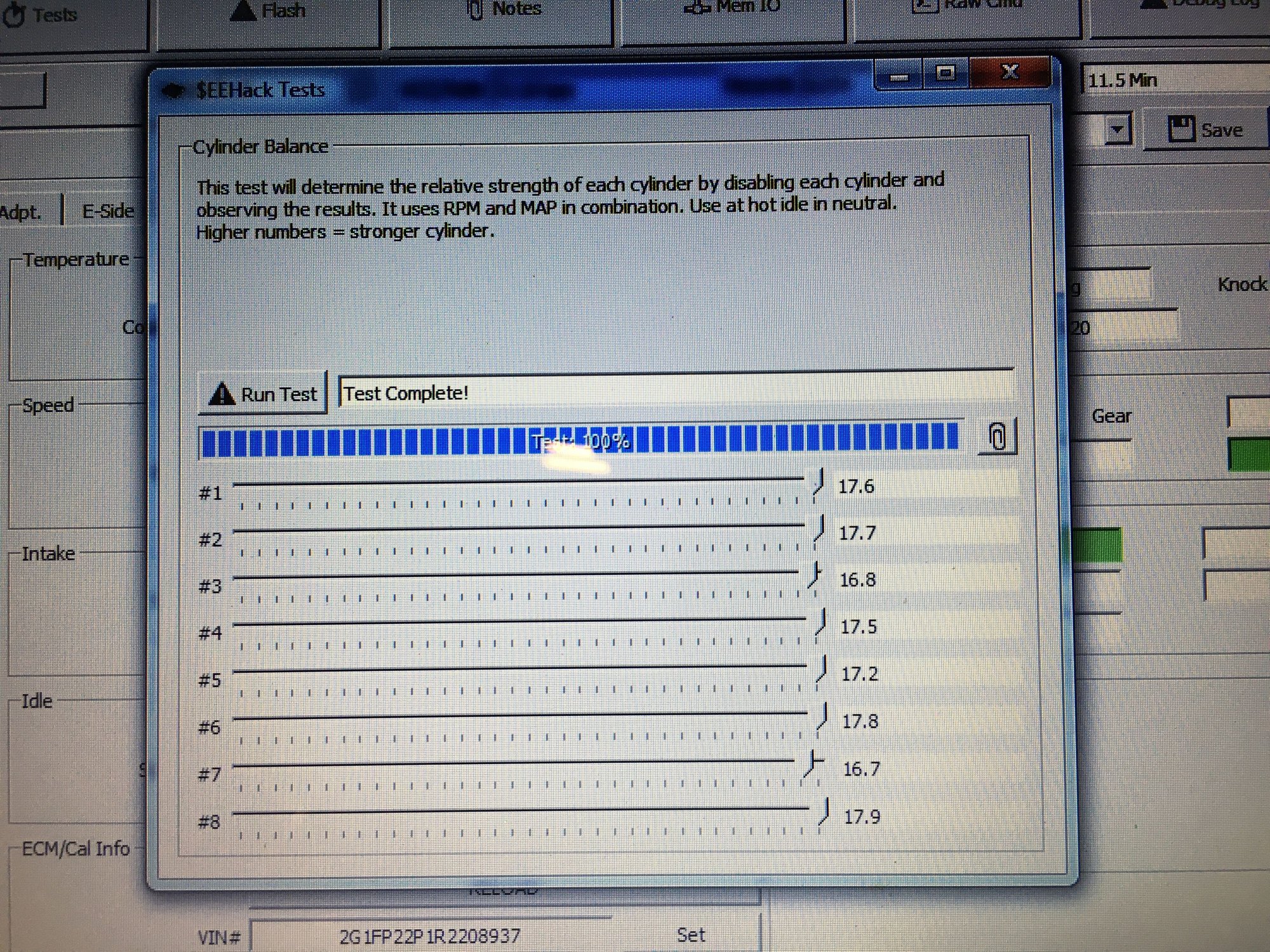

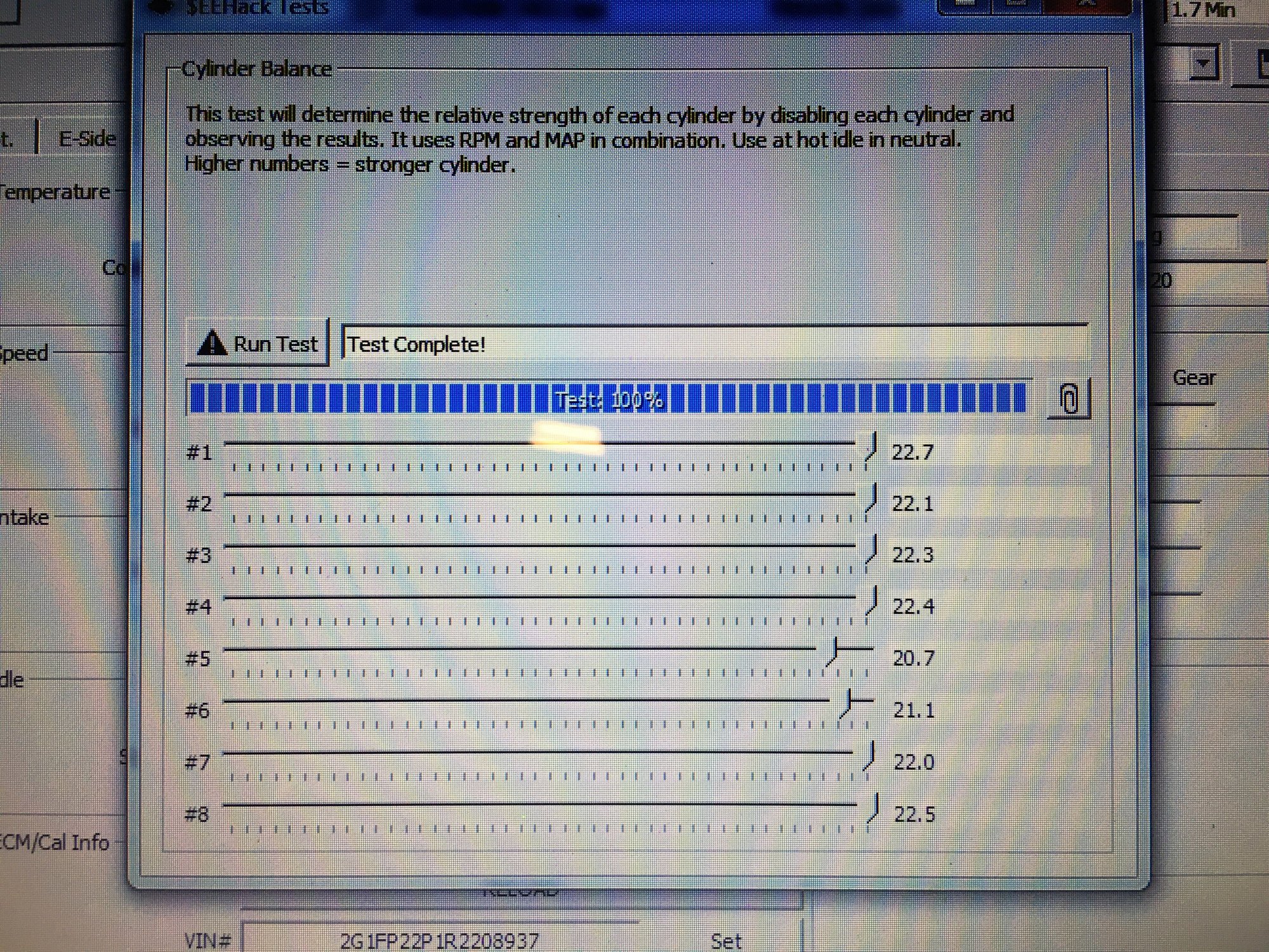

You might be on to something here. I noticed something when doing the test. Immediately after beginning the test, the PCM starts acting to correct for conditions that the o2 recognizes. When the test starts dropping cylinders one at a time, the overall equation begins changing as the PCM starts attempting to correct. You can see it in the fuel trims if you watch during and at the end of the test.
So I figured through a curve ball at it and I did the test in open loop. I used the control panel to force open loop and tested at 100 degree and 195 degree coolant temps. Here’s the results with the cooler one first.
Open loop 100 degrees coolant temp
Open loop 195 degree coolant temp

I think the test might be good for quickly finding a seriously deficient cylinder, but not so good at finding smaller to mediocre differences

Oh wow, this looks WAY better. Okay, I wonder if forcing the car into open loop should be a requirement for the test. I didn't know it was trying to do corrections on the fly despite a clearly incorrect operating condition.
I mean, based on your 195-degree open loop test, I'd say your engine is fine.

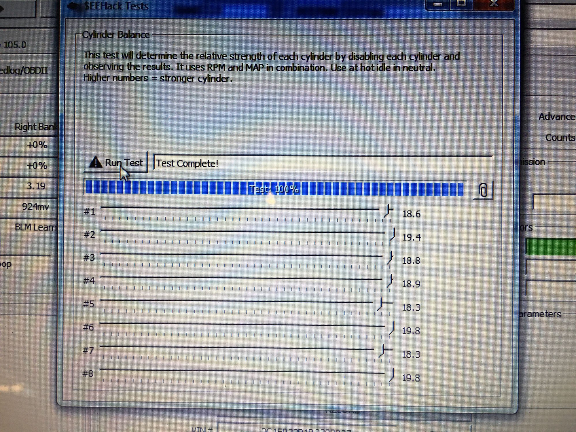

52mm Holley installed and working great. Here’s a closed loop 195 degree coolant test result with the 52mm.

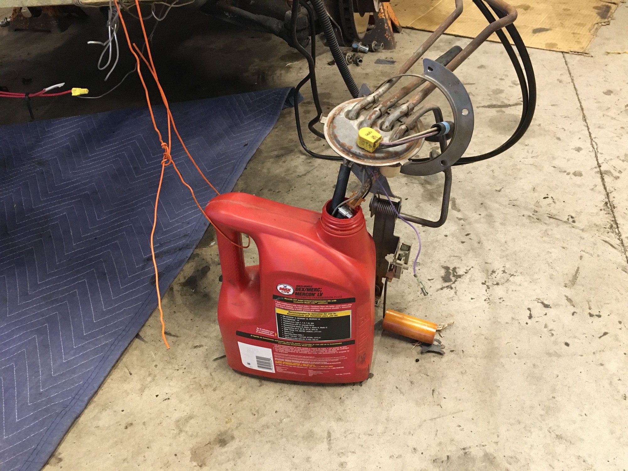

Another part of my problems might be my temporary fuel delivery system. Although the pressure at the rail is correct, I noticed the gallon container warming up quite a bit. I’m thinking if I run it long enough and the gas gets too hot is can oxygenate or approach the vapor lock stage.
Obviously the hot gas returns from the rail and into only the gallon jug. If it were traveling back to a 20 gallon tank with much more gas in it, the heat would not build. But let me tell you, it’s building in the gallon jug.

That's...certainly an interesting setup.
