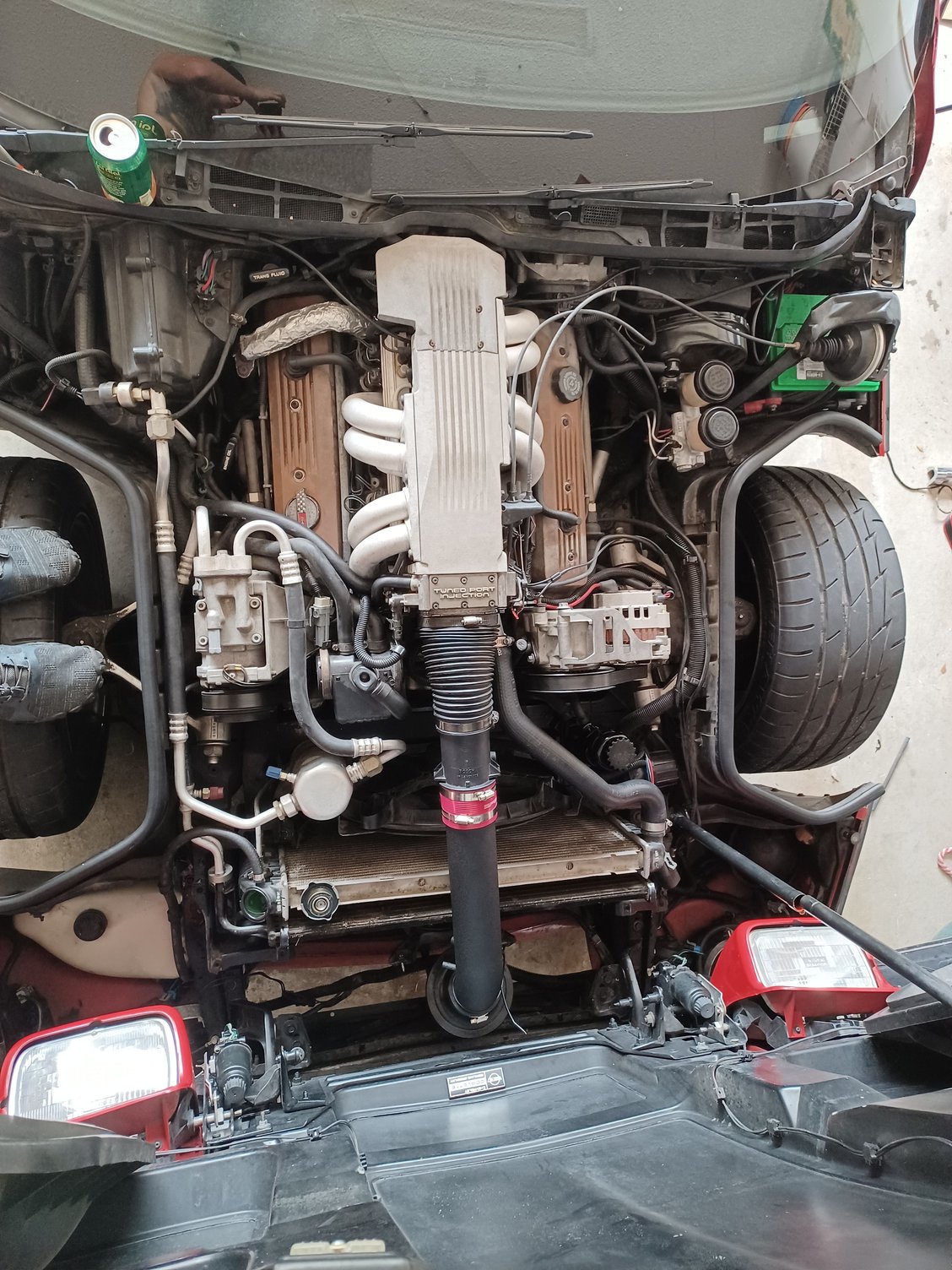

I slapped a 6inch K&N air filter in my car. I was reading around and people were saying it won't fit or its not going to help much. I ended up taking the Radiator Shroud off and the hood closed just fine. I Was able to connect the front fan to the intake tube with zipties (changing to brackets soon)
Why did i do this? Because my engine gets to hot and i was hoping this will help. If it fits, it sits lol I just changed thermostat today, hopefully that'll help too.
Wondering with the Shroud off if that wont make to much air flow around Radiator instead of going into it.
(Radiator cap is off because i still have to burp it)
Its not pushing on Radiator or anything
Still have to vacuum out some more **** from the radiator, it was about half full of debris. I dont have air compressor
I dont know anything about cars, if im doing anything incorrectly, let me know lol i have to learn somehow.

Air follows the path of least resistance. With no shroud, there is no reason for much airflow to go through the rad.

So if i just cut out the area needed for airfilter to fit in the Shroud it would be fine?

My suggestion is that you put the stock components back on.
But clean out the radiator area and possibly replace the radiator to solve your cooling issues.

Not trying to be a bummer, but it's highly unlikely what you've changed is going to help cooling at all. In fact, it will probably make it worse.
The radiator needs the shroud, both when moving and when sitting still with the fan on. When moving, the air is not going to be directed through the rad properly. When sitting, the fan will just be pulling engine bay air in from it's tips and blowing it around. The shroud forces the fan to pull air from in front of it and that means it draws air through the rad.

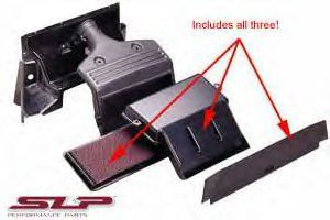

Or if you want a "better" intake housing, look for a SLP kit to show up on one of the "used" sites. Not sure if you can still buy them new. I have one on my 88 and what it does is replace the filter cover.the new cover does away with the "louvers" and closes it up. then , there's an opening on the bottom that extended down to where it can get cool, fresh air with a bit of a ram effect. That's about the coolest air you're going to get. Don't expect to see a noticeable difference in power (or sound), but it is a little bit better design for our "bottom feeder" air inlet. I could only find a small pic on the net, but it will give you an idea of what it does:
