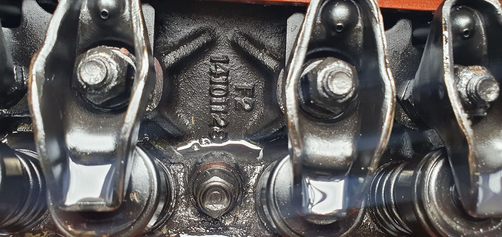

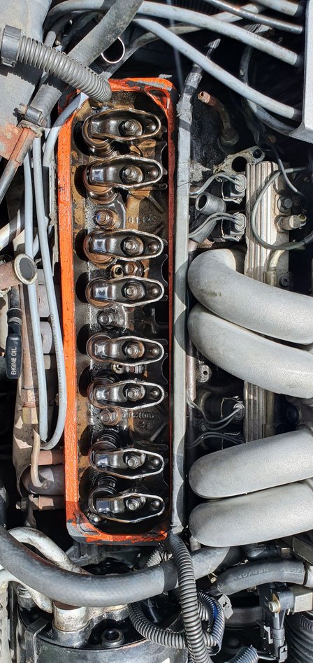

Update: Pulled valve covers and everything was still intact and didn't look damaged. Seems like the noise is definitely coming from bottom end after all.. Here are some pics:
Right side^
Left side^
Head Casting #^
Old Jun 19, 2021 | 11:42 AM
cv67's Avatar
cv67
Posts: 81,241
Likes: 3,063
From: altered state
St. Jude Donor '05
I can see shavings from here, just pull it out its time.
