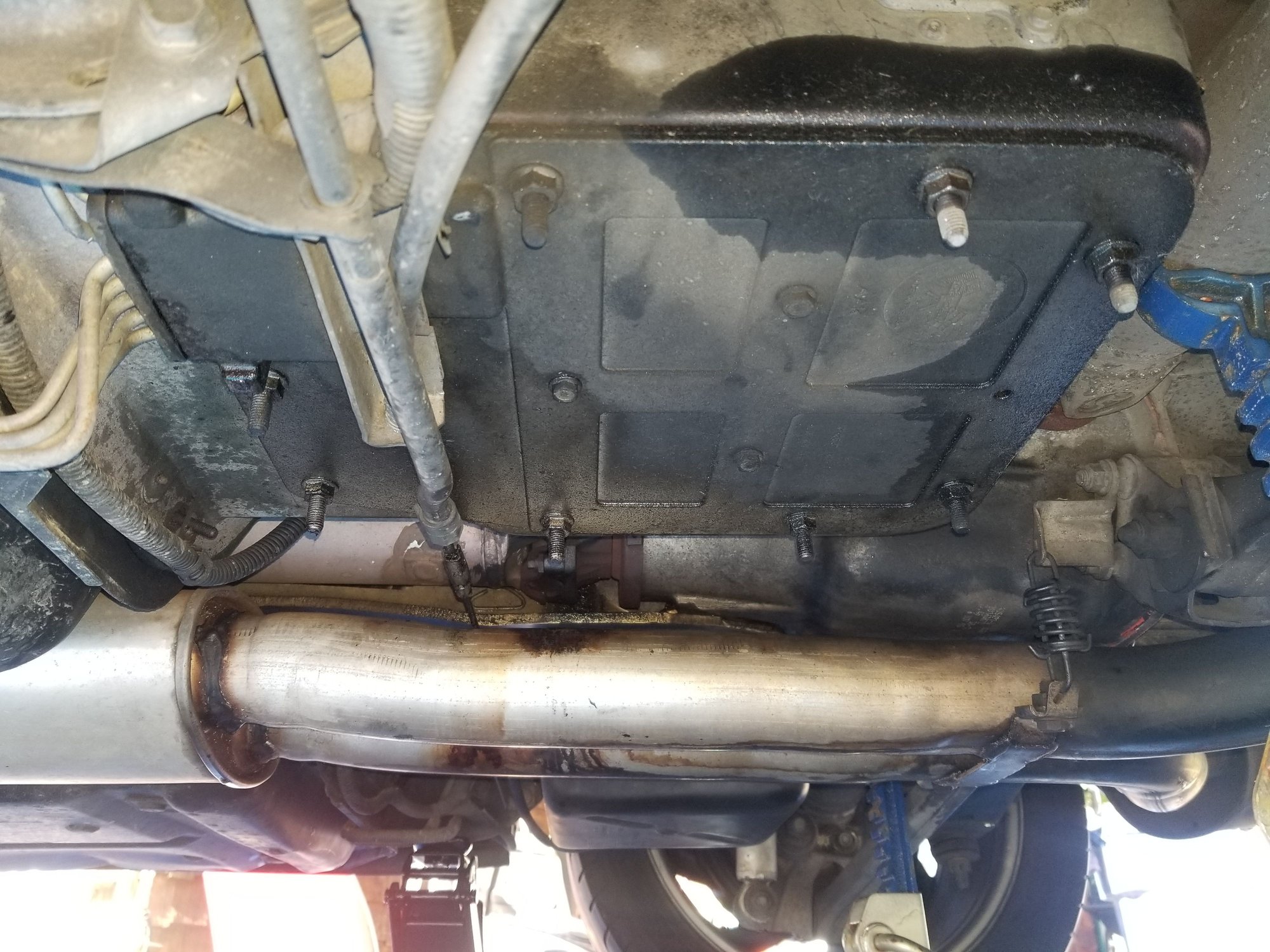

What is this pan for, and why is it leaking? Bad gasket?
It's in the rear, to the driver's side of the differential

Im thinking the ABS unit may be located there, someone that knows for sure should answer soon.

Yes the ABS is above, you can access it through the storage hatch it may be screwed shut with 7mm head once open you can start your inspection for possible problems
Looking at the picture I would give a look the Differental, you're pinion & 1/2 shafts looks like it's leaking. Sniff test the staining on box might be Differental grease

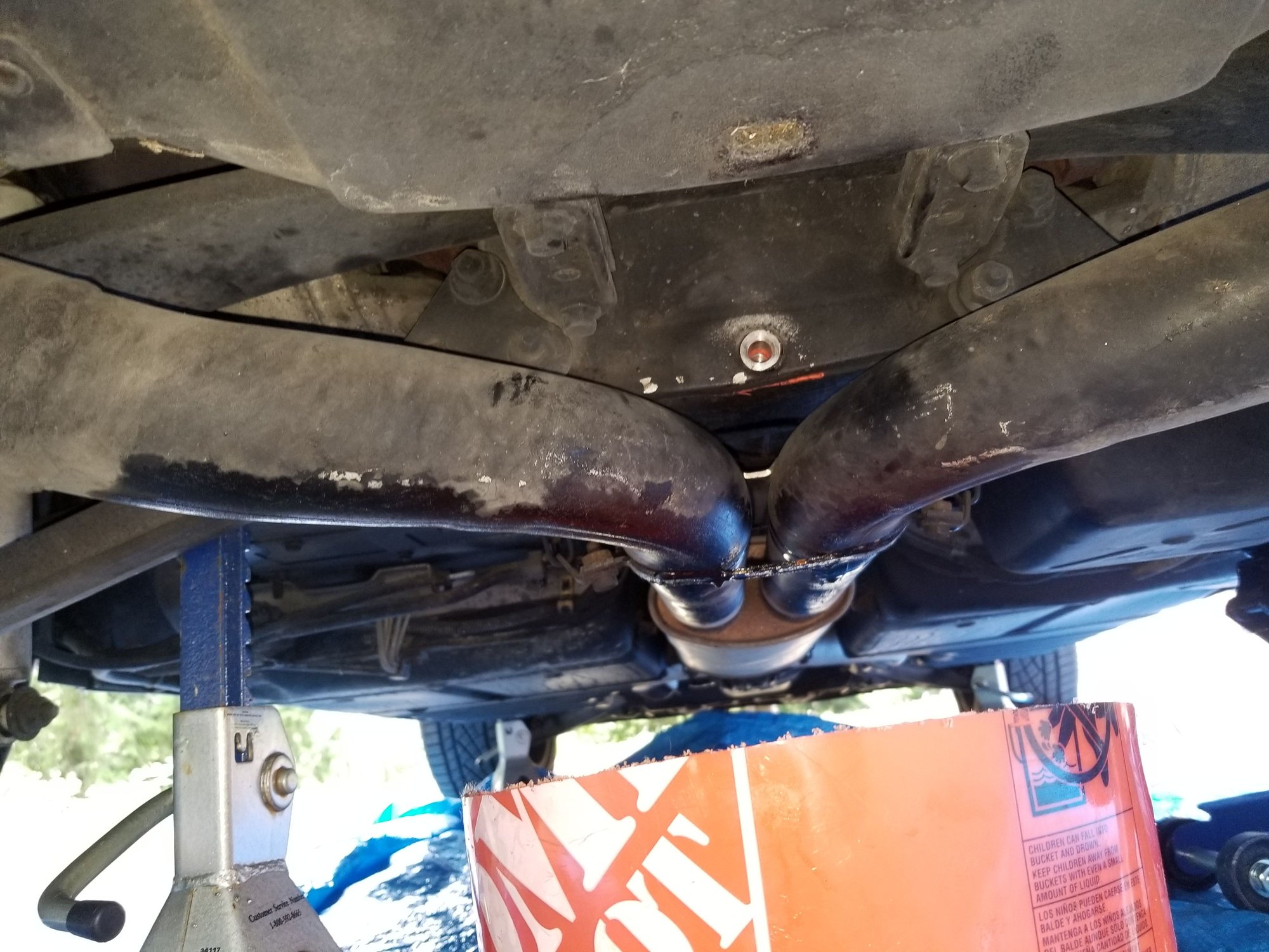

Thats the side of the diff, the fill plug on the left. There was fluid in the outline areas
There was a lot of fluid below the diff
Below the diff

Uh, the rear diff was modified to turn the bottom-middle cover bolt into a drain plug?
possible? It would only take 1 or 2 careful minutes with a drill to cut out the back of the bolt hole.
But I think the bolt is MIA.

The only fluid in the abs is brake fluid, so if it is leaking you would be low on brake fluid. Most likely the fluid is coming from the front of the car and streaming back on to the abs compartment.

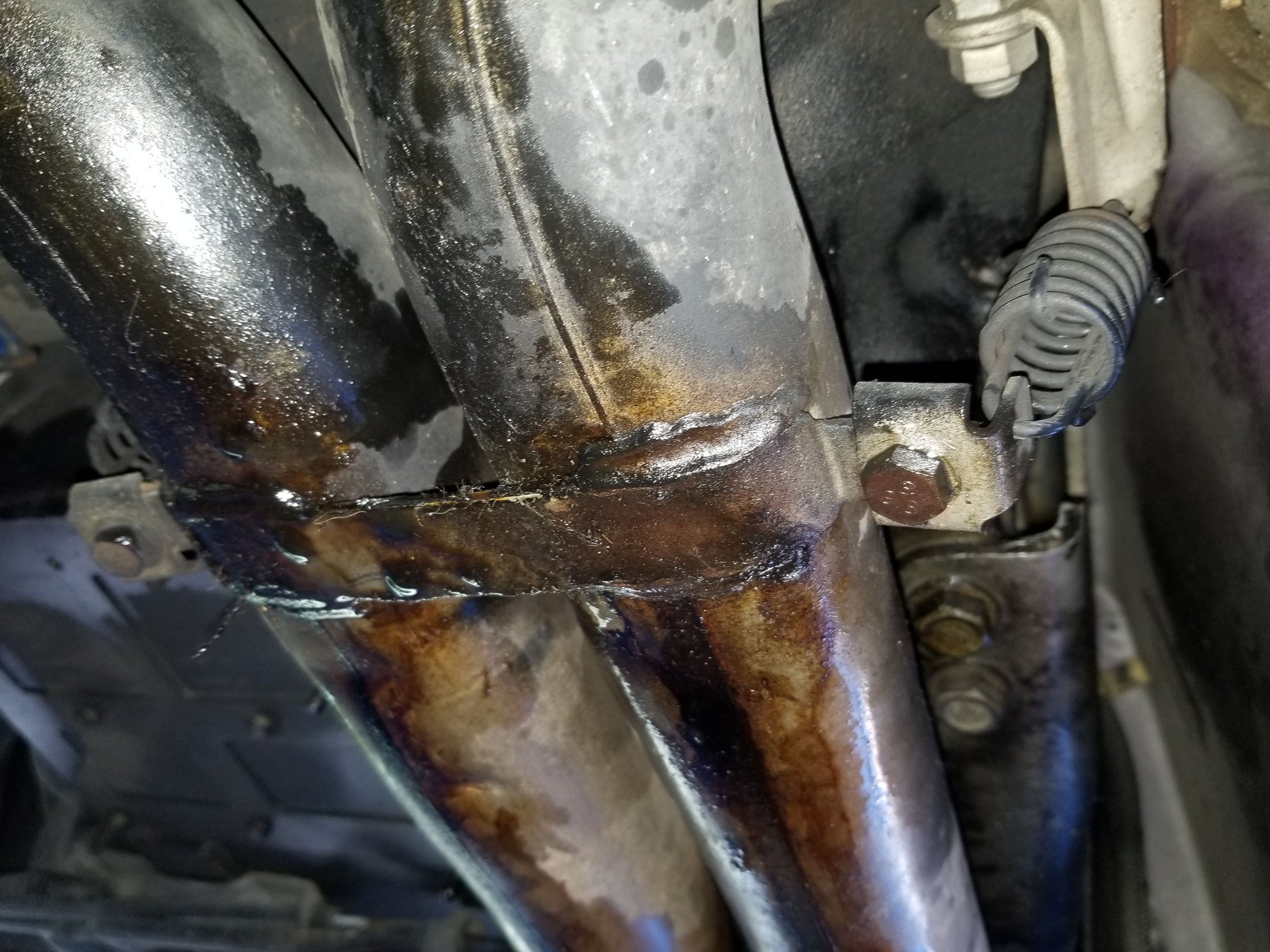

I'll get the compartment open and take a peek anyway, but I did the brakes last month and was not leaking any fluid. Something near the diff is leaky for sure, you saw the exhaust pics, they were covered. And above the diff was dirty too

I really thought that would be the drain plug but no. I replaced the screw, but listen. There was still a small amount of fluid in the hole. Could be that cover plate is leaking... could be leaking more so on the top, which would explain why it would be dirty above the diff

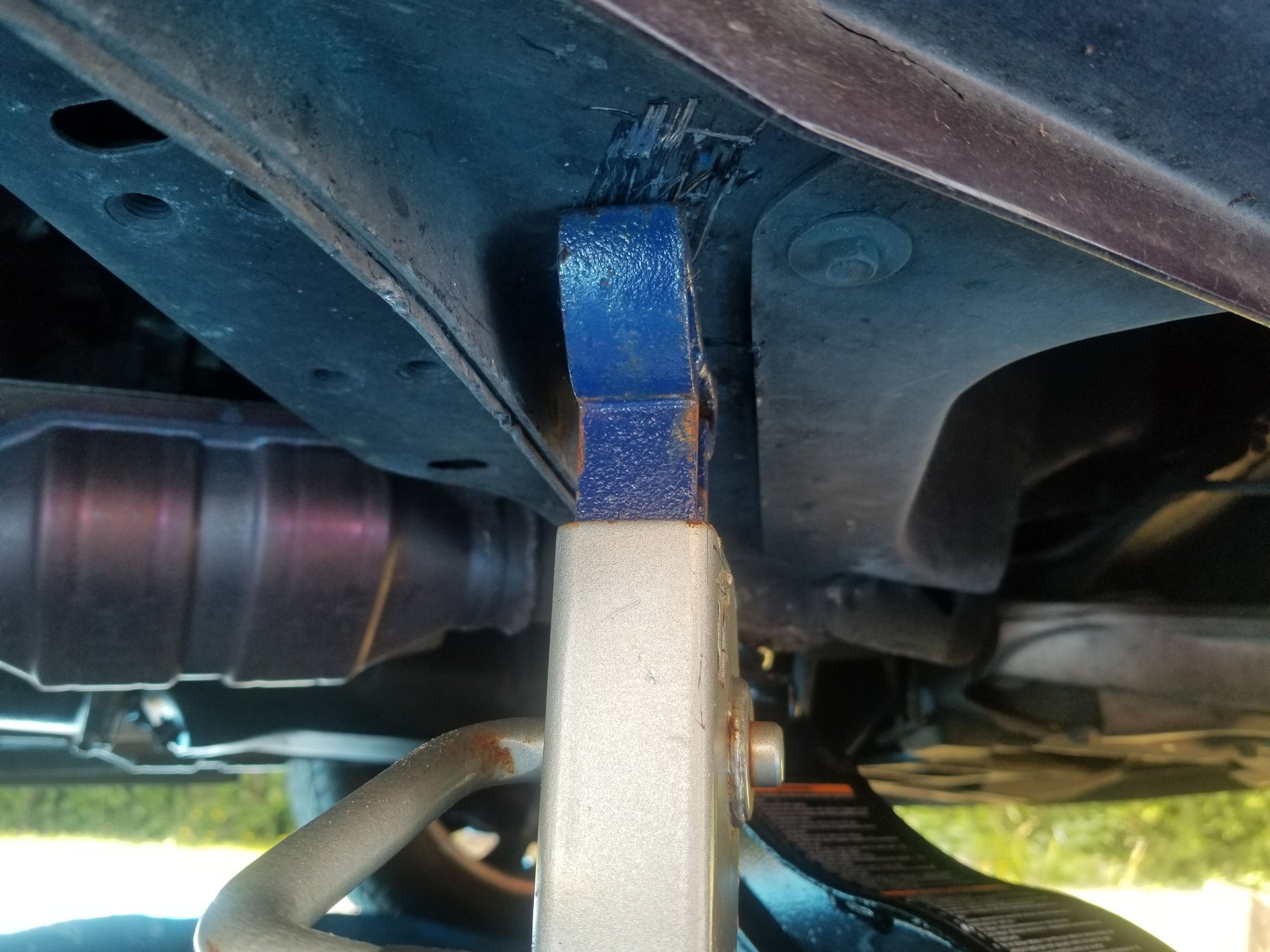

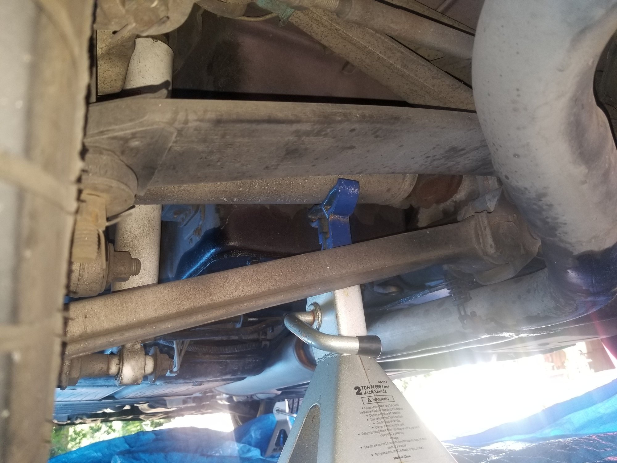

I placed my jack stands like so. What is a better spot for the rear?
Front
Rear
thanks for pointing out that these are aluminum and thin walled

Yeah nah, the Dana 36 and Dana 44 on the Corvette do not have drain plugs from the factory. There are several ways to modify them to add one. For example: https://www.corvettecentral.com/84-9...-kit-nd-584029

For the rear, how about the inside of the lower control arm where it meets the diff?

Originally Posted by ihatebarkingdogs
Safety First. The further outboard, the more stable the car is on the stands. How about under the pinch welds at the indicated jacking points?
I didn't do that because the pinch welds are too close to the body for anything other than the jack that came with the car.
I just ordered so jack pucks cuz my pinch welds are looking ragged. Those might fit over the body and the weld. But it would require 2 floor Jacks. Which I totally could do, just lmk what the safest thing to do is. It's a big fear to die under a falling car, no thank you

Usable jackstand points shown here:
https://www.corvetteforum.com/forums...jack-a-c4.html

I would never use the halfshaft to support the weight of the car, that is just begging for premature u-joint failure. Suspension components are OK, but as mentioned previously, the frame (as far outboard as possible) is the best location.
