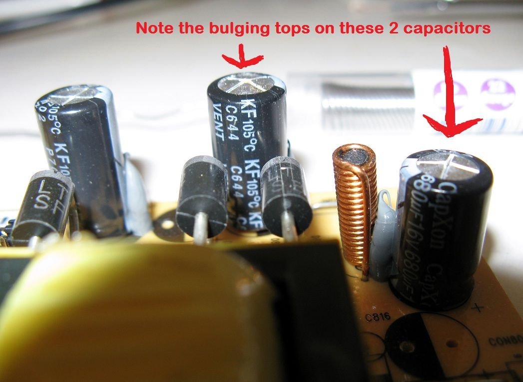

I doubt it's a simple problem, probably a safe bet that the radio has a short. There is a hot lead that runs to the radio that it keeps memory and clock settings..capacitors can fail and become a short which might be the problem and also cause a low whine. If you have the radio apart see if any of the capacitors are showing like the tops are bulging.
This is an example pict.
To 1990 Bose Gold - Draining Battery while Turned Off
