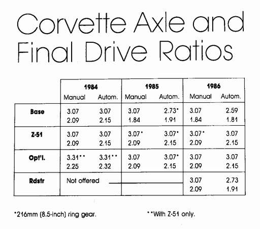

In this book 3.31 is listed as optional for Z51 only:

The Road & Track August 1983 test had the 1984 Corvette automatic with 2.77 ratio equal to the Porsche 928S on 7.0 seconds 0-60 mph, with the Ferrari 308 GTSi on 6.8 seconds. I am sure if the Corvette had the 3.31 ratio it would have beaten both cars with 6.5 seconds. The rivals were both stick shift BTW.
From the above it seems 3.31 was a very rare option with G92 + GW4, I would have liked to see more magazines have tested the 1984 car with that ratio. Would have sharpened up acceleration and left top speed unchanged I think. However, at the time the 1984 car was already quick, and CAFE was very important, plus most buyers would have liked the easy cruising of taller ratios.
You can always add a 3.31 to your car, but I would like to think you could have ordered it from the factory via a normal RPO. In any case, the 1984 Corvette was pretty good, and close to the final LS4 C3 big blocks in performance, but with an extra 6-7 mpg economy. Would have been 500lbs lighter as a car.
