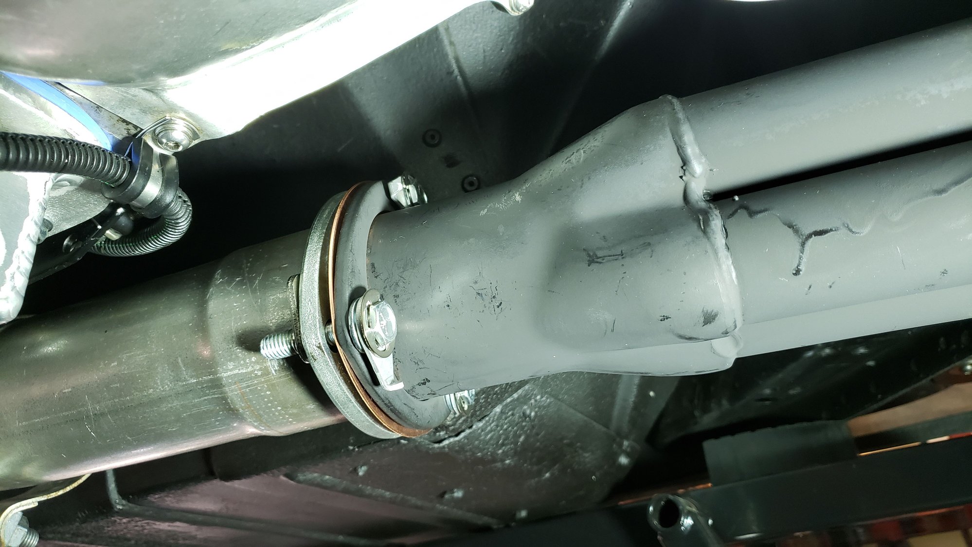

Header bolt backed out. Not sure how long it has been like this, but hasnt leaked.
93 LT1 DRM 1 3/4 SS headers, with Fel Pro gaskets. Cylinder #3.

Found the problem. After putting the bracket into bolt to the air conditioner, I took the bracket off cause I was trying to troubleshoot vibration from the air conditioner. The bolt I used was longer than the time sert, so when I took it out it loosened the time sert.
i have a new time sert I will install soon.
Arp bolts are fine, the other ones after wel over 12 years, are still tight.
This was purely owner error.

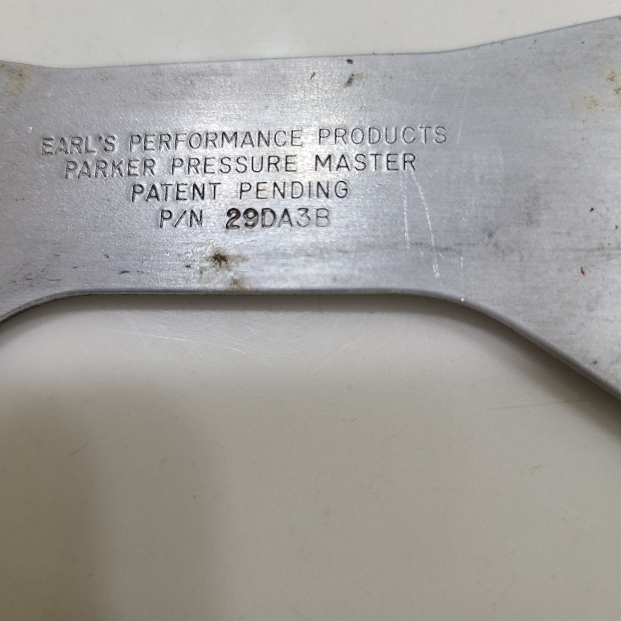

Years ago I used these header gaskets. Never an issue.
Good flat headers make a big difference too.
https://www.earls.com.au/shop/earls-...eader-seal-16/
