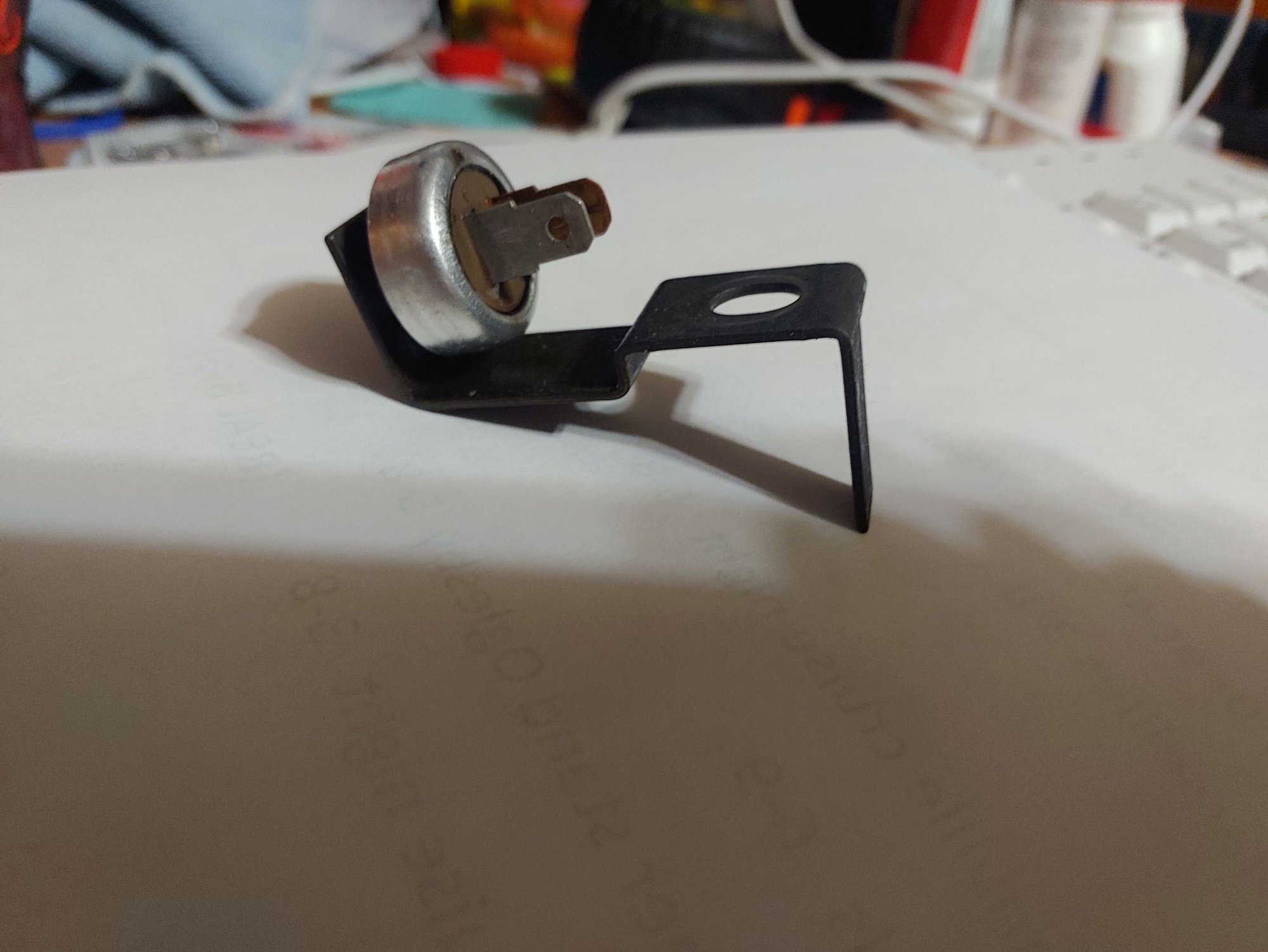

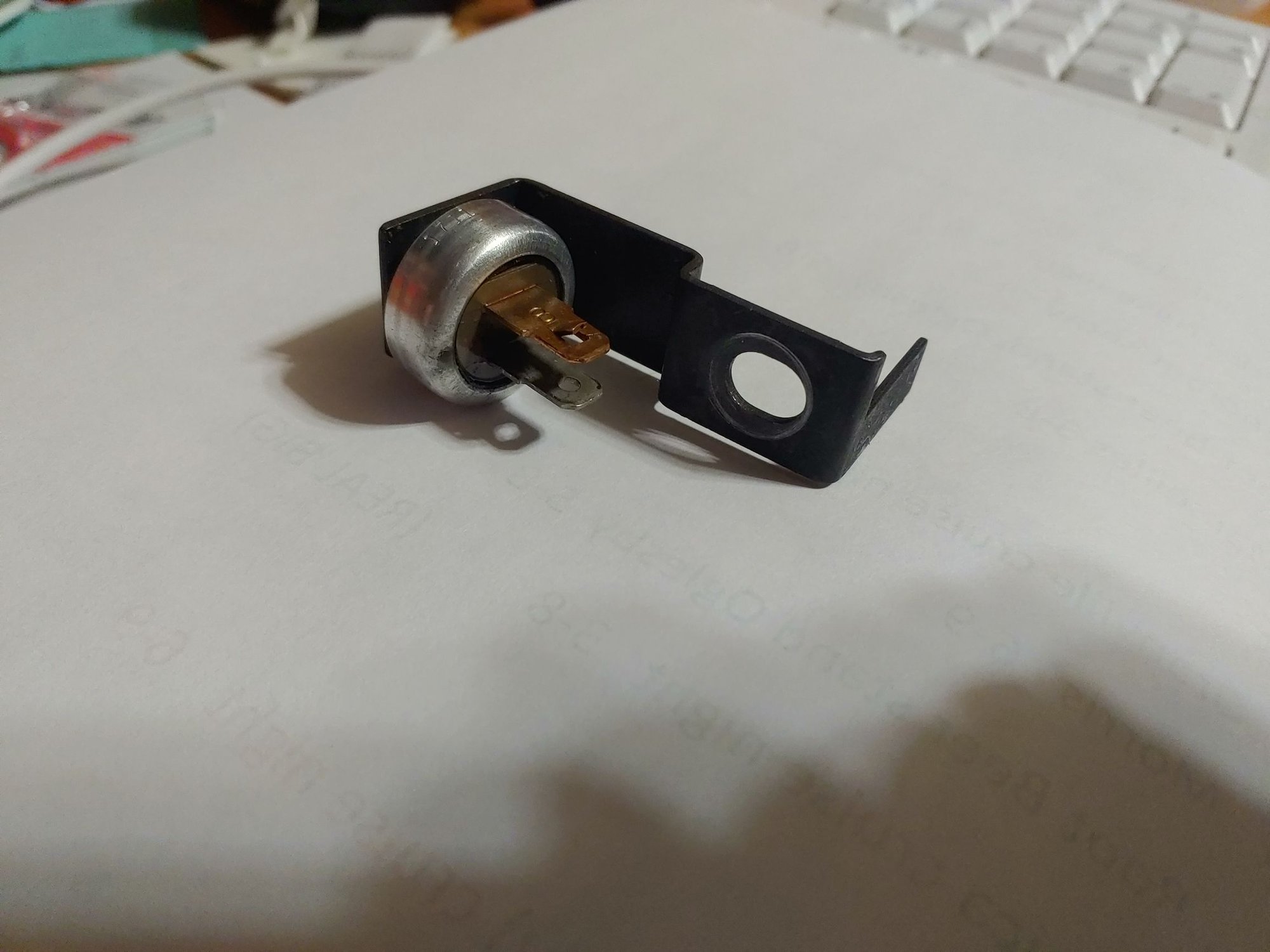

I will try to clarify things which I should have done in the first place. The trans is completely stock and the lockup worked just fine and I could feel the shift, even in third if I switched it then. Normally I would wait for the shift into OD then flip the switch. Been that way for some time. Then the "Accidental" neutral drop happened, don't even ask, I didn't do it. I was trying to get the lockup back and wasn't having any luck so I dropped the pan. Nothing out of the ordinary in the pan but the solenoid was dead when I tried to apply power to it. So, I got a new solenoid and wired it up the same as it was which is power to the brown wire and the tan/black and the green spliced together. Tonight I tore everything back apart and took a look at the whatchamacallit in the attached photos. Does anybody know what it is? The 2 terminals have no continuity and show no ohms, not even from the terminals to the housing so I am guessing it is dead. But, if it is dead why is the solenoid clicking?
Old Jul 6, 2021 | 06:43 AM
Phobos84's Avatar
Phobos84
Joined: Mar 2002
Posts: 2,874
Likes: 764
From: Sligo PA
That's your temp switch. I can't remember if it's supposed to be N.O or N.C. but it won't show Ohms like a coil. It's a switch not a sensor.
Old Jul 7, 2021 | 12:37 AM
Midnight 85's Avatar
Midnight 85
Joined: May 2004
Posts: 5,866
Likes: 60
From: Hellinois
Finalist 2020 C4 of the Year - Modified

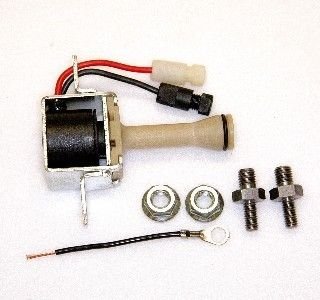

The temp switch was bad and I asked a guy who does transmissions for a living about the solenoid I put in. The old solenoid was bolted in right up against the case but the new one I got had 2 studs included that had a hex head in the middle which spaced the solenoid out of the case about 1/4 inch. He told me that the one in my transmission was correct for a 700R4 but to use the hex as a spacer was actually for the 200 trans. He advised me to put the solenoid all the way in and tighten the studs down on it, or, in this case up to it. Lockup is working just fine.

Yes a 'universal' TCC is serviced that way for the 200R4 & 700R4. Had you bought a 700R4 TCC with the harness I don't believe you would have had your situation. For anyone else that might buy assuming the studs are required you've answered the question! TOSS EM'!!
Your buy was something similar to this?

Yep, that's it. Made by Borg Warner, at least that's the box it came in.
