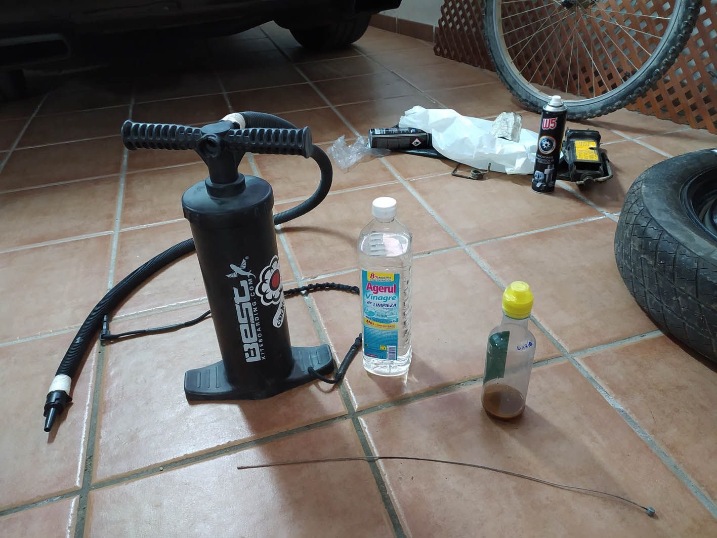

The same thing happened to me. The coolant overflow tank does not operate. Observe that the water did not move from one tank to another and what happened is that the tube was clogged by the years that my 92 vette has.
I unplugged it. Add cleaning vinegar and leave it for a few days and then with a push wire until you remove the blockage from the tube.

okay. But what happened to me was that the tube between the two tanks was clogged
