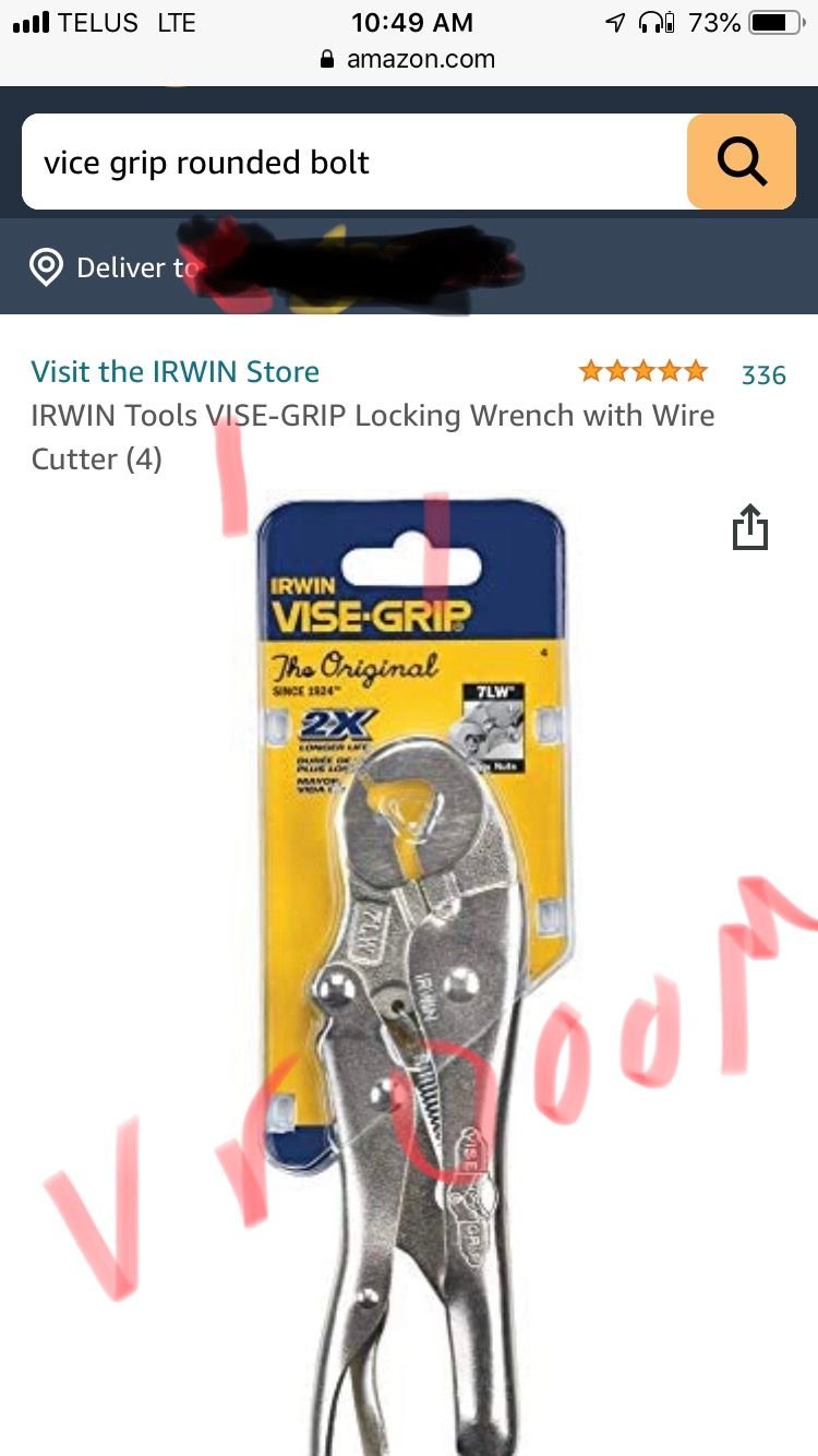

another option i use frequently are these specific style of vice grips.
https://m.youtube.com/watch?v=k1GT4wrPF5U
they work amazing. they grip much better than the standard toothed style. available on amazon.
