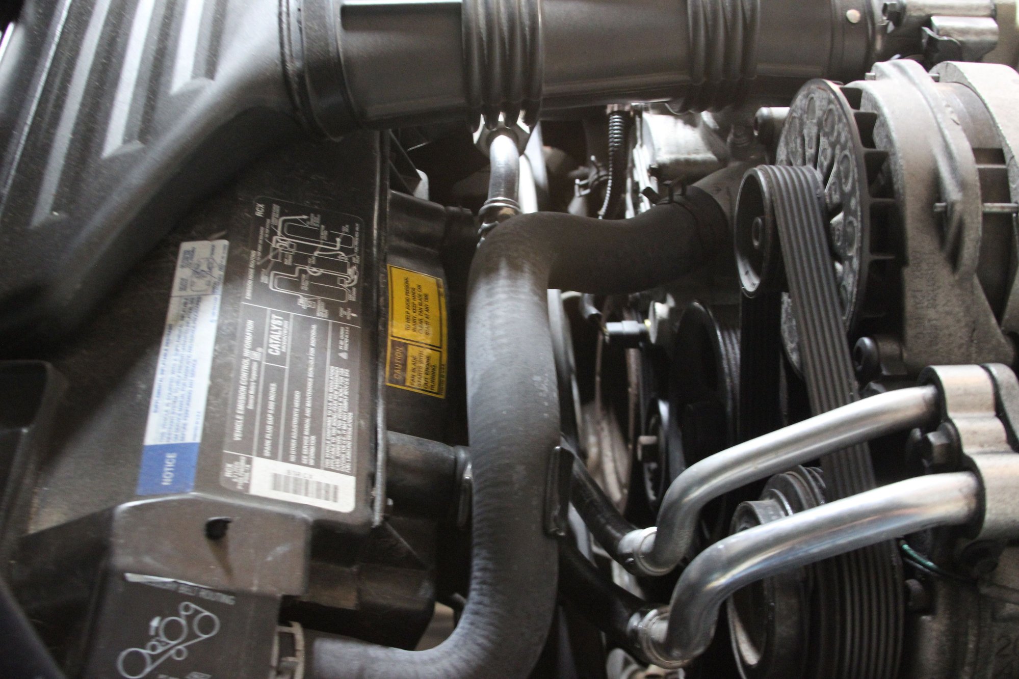

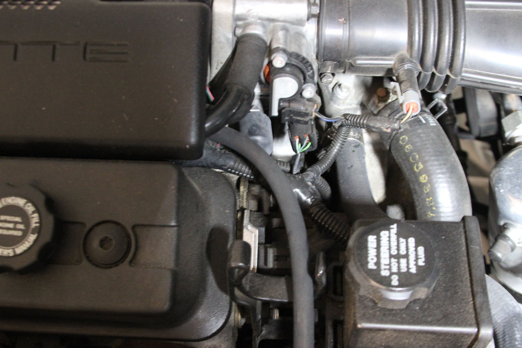

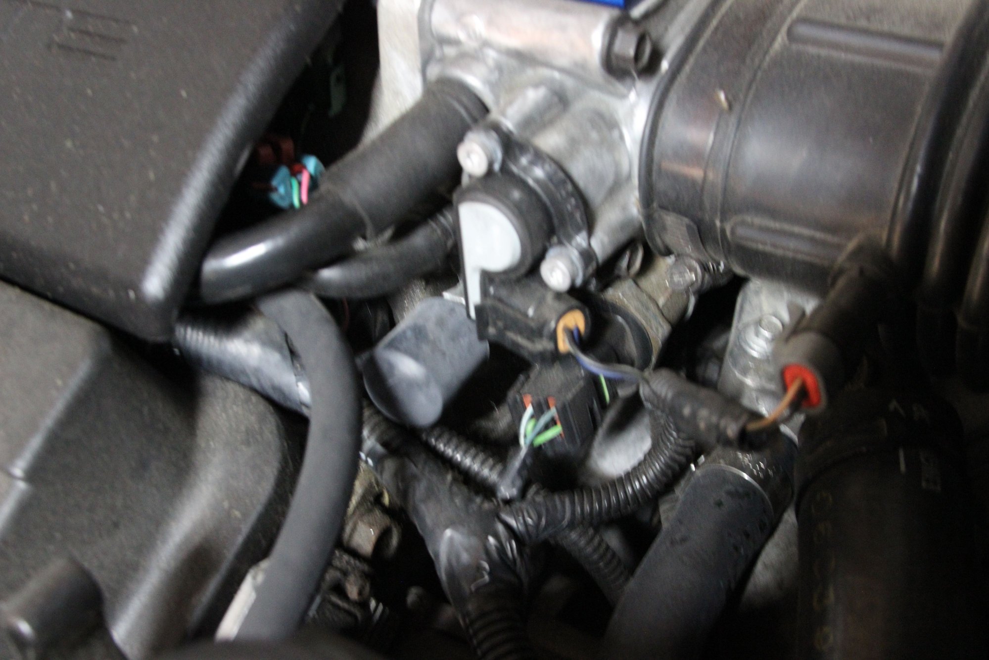

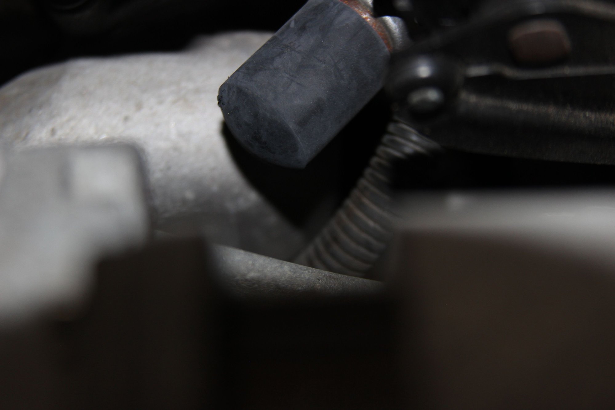

That's how I did my 93. I'll have to take a picture of mine. I also had to replace the hose that goes to the heater I believe. All I remember it makes a nice clean job.
This is the passenger side with a rubber cover over the outlet pipe.
Passenger side showing the bracket that held the original hose which I did away with.
The drivers side showing a new 96 upper radiator hose without the tee for the TB.
This is the Drivers side TB outlet pipe with cover.
