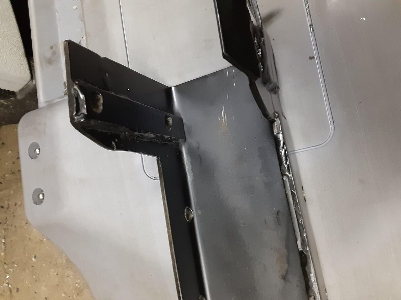

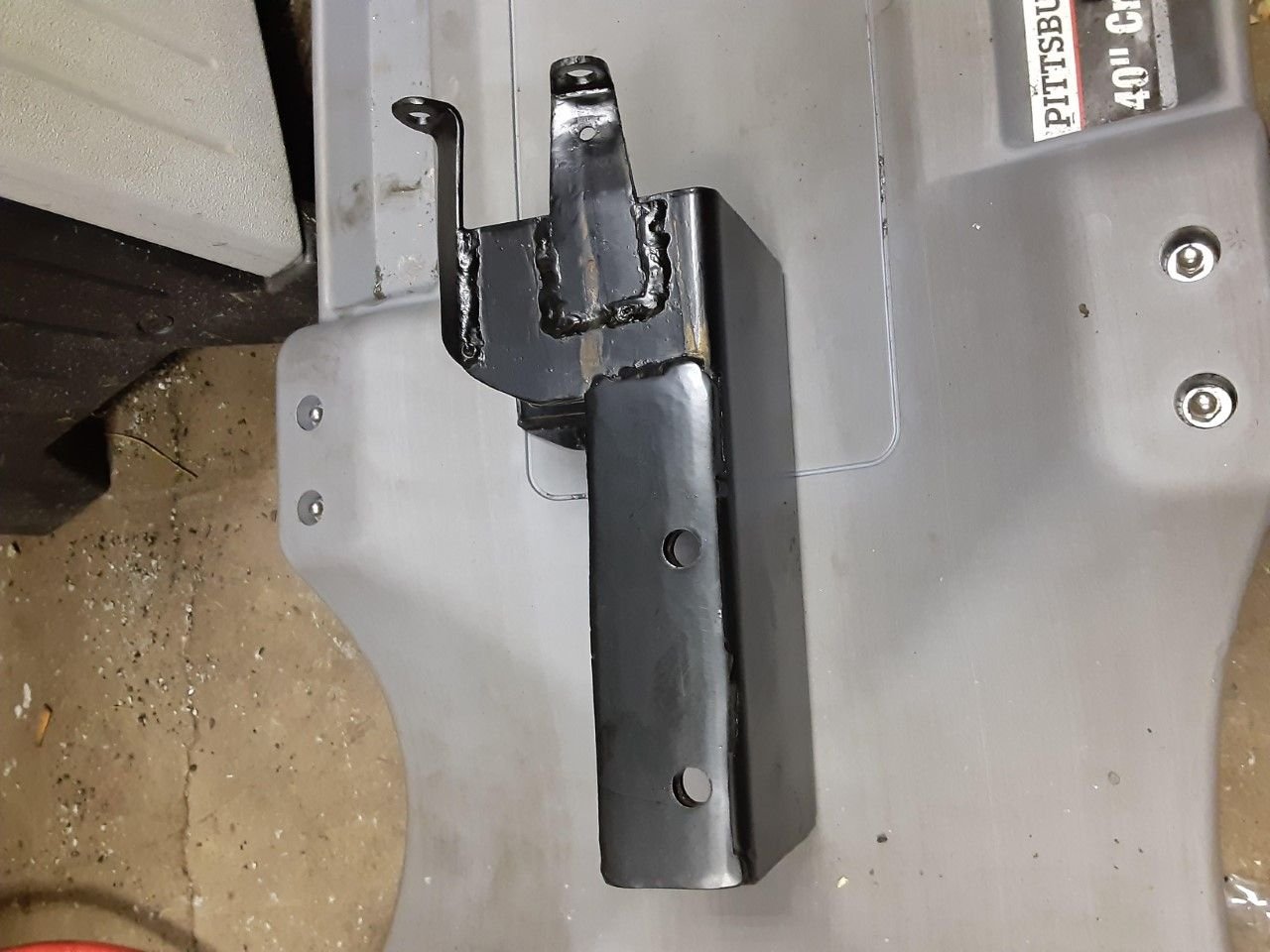

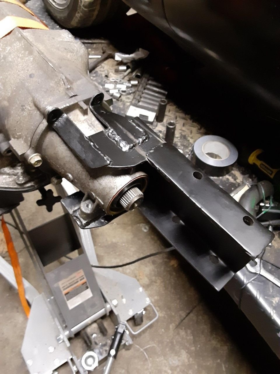

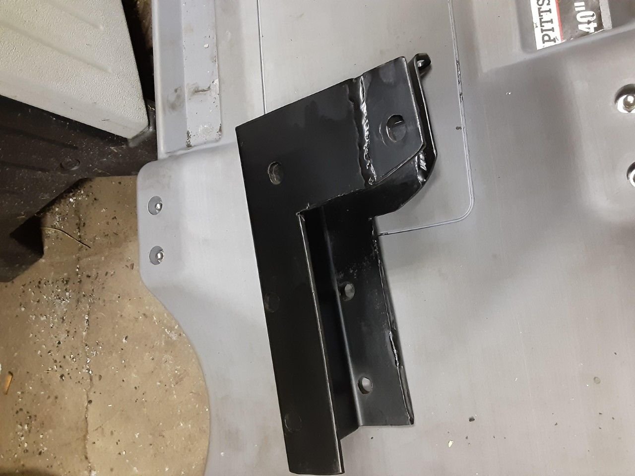

With the aftermarket controllers available now upgrading to a 4L60e or a 4L80e is much easier and much less expensive than a rebuild. I've had both 4L60 and 80 in my 84. Other than fabricating the C beam mount it wasn't that bad. The factory driveshaft will work just fine with the 4L60e. If you ever want to step it up to the 4L80e you will need a shorter one. The best part is that once you go that route not only do you get all the advantages of a computer controlled transmission but if you ever need to replace it 2wd 4L60e's are so common in the wreaking yard your practically tripping over them. You rarely ever see a 700r4 laying around anymore.
In fact if you live anywhere near Clarion, PA I still have my low mileage 4L60e and C beam adapter that I made sitting under my work bench that I would love to sell you cheap.
These are some pictures of the adapter I made for my 4L80e. Just some basic welding skills needed for this. Don't let this part scare you off from swapping in a transmission. It was easy.
