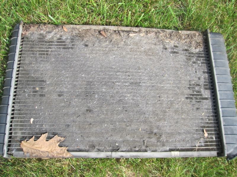

You've been told that the seconday fan doesn't come on until very hot. Unless you are just about overheating it's not supposed to come on.
Take the radiator out and clean if you want cooler. This is possibly the way yours looks and you can't clean unless out
