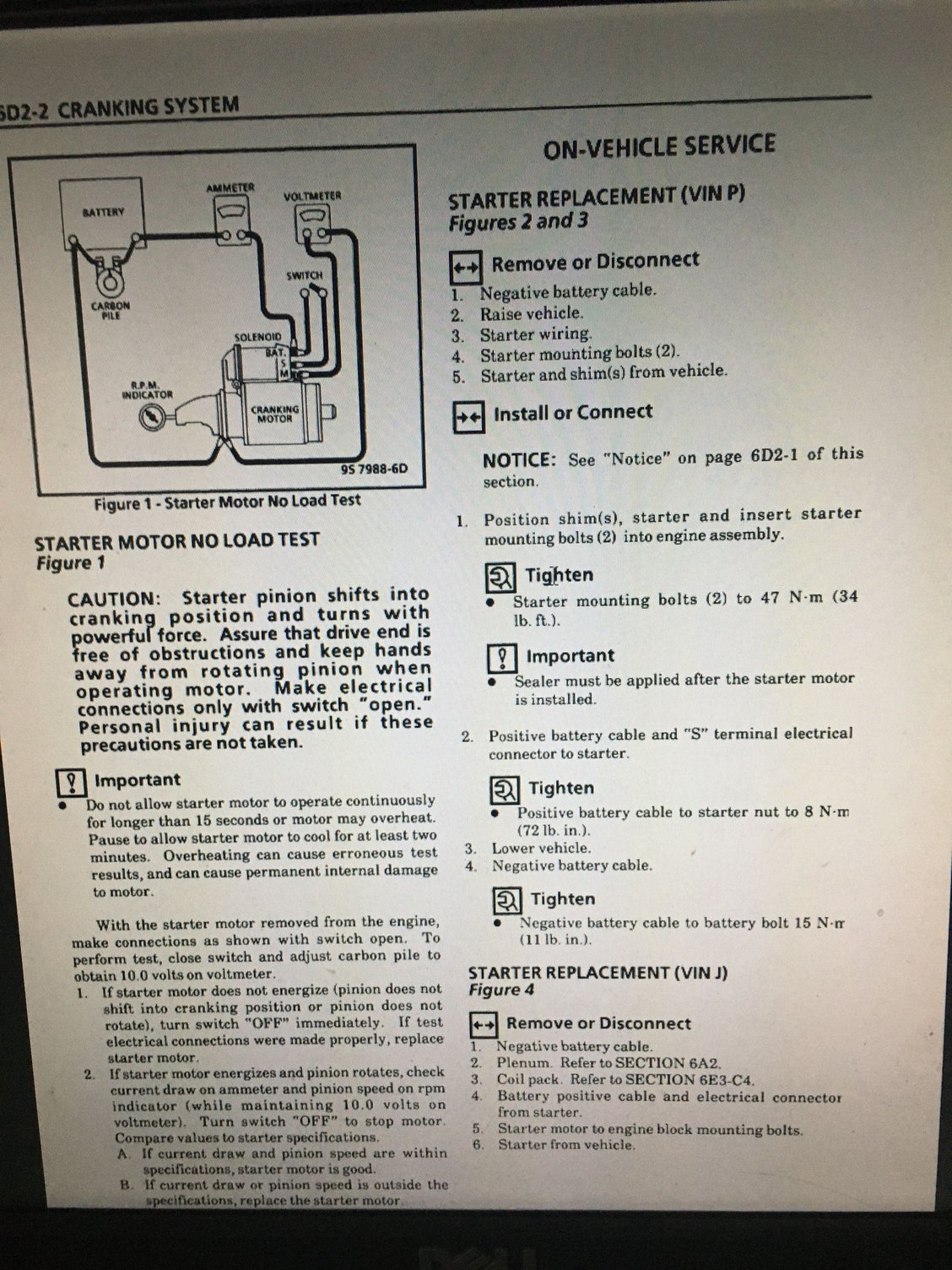

I have a 1992 base model and I am putting in a new starter. Factory service manual says place shims, which there were none there after removing old starter. next it says important add sealer.
Where would I put the sealer and what is it?
What can I do to get shims and how do I tell if I need shims?

Is the starter you removed an original? Can you post a snapshot of the label? Was your purchase 'local'? If your removed is thought to be original don't use it as a core! If your new/reman/whatever is still returnable you might consider it after answering the first questions!

I already turned in core, it was a remanufactured ac delco
