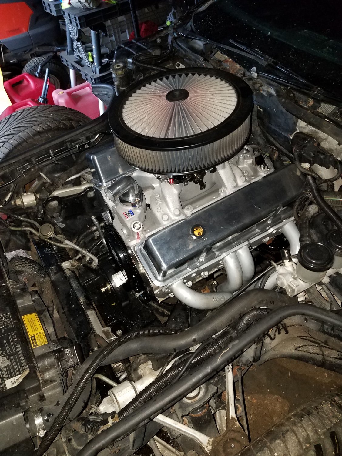

just basically a backyard polished crank, rering refurbished everything i could because there was nothing to buy due to covid while i was doing. lunati .515/.530 voodoo cam lunati full roller rockers, dart 180 cc shp gasket match ported intake and exhaust sides, with matching dart stud girdle... hookers 1 3/4 tube header with pypes race pro exhaust with x pipe. edelbrock performer rpm air gap intake with holley 750 ultra double pumper. stock mahle piston stock hand polished crank stock oil pump with high pressure spring installed new rings/rods and cam bearings...pro form electric water pump, ac , air pump and all idler/ tensioner pully deleted all done by me no outside sourcing what so ever. i did ever bit of work to engine myself. have a afr gauge i will be using to tune with and mount that on the pillar post so i can see it at wot. it should run good. 6 speed with dana 44 and 3.42 ratio. and for those of you saying wtf CARB...??? the car was already on fire and melted the original fuel injection before it was mine due to a leaky o ring at the injectors. the guy i bought it from had it completely hacked up. and beside i LOVE the sound of a good carb hitting hard
