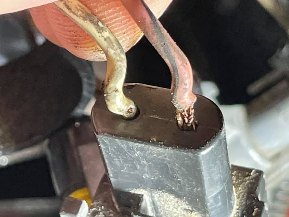

It took a few weeks but the mystery is solved. The ignition no-spark issue was caused by the black coil connector down to a few strands of wire. It past the diagnostic test and was hidden by the beautiful new tape and loom I put over the connector while motor was out...that was a PITA to isolate.
