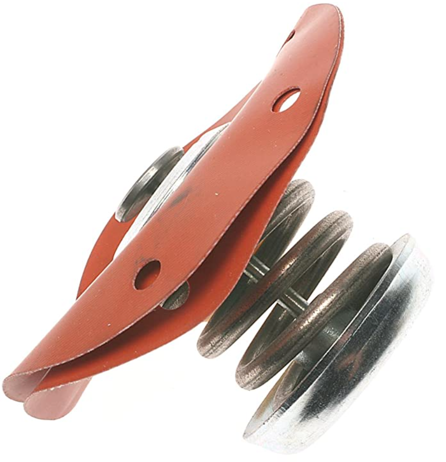

This will be my next step. From the service manual and videos that I have seen, it looks like the part is referred to as the "diaphragm" on most sites. The return for "FPR" from the big box stores gives this Delphi part. Another example is this corvette supply store (https://www.ecklerscorvette.com/cata...re%20regulator). Am I missing something here, like a larger assembly that is seated deeper?

That orange part is all of it other than the stamped steel housing. It's unlikely that your orange diaphragm is bad (torn) as that doesn't affect fuel pressure typically and it also causes too much fueling since the fuel passes through the tear in the diaphragm and goes into the intake. For the regulator to cause low pressure, either the spring has to be broken (never seen that happen), or there could be debris between the little round "button" in the center, and the orifice that it's trying to plug.
