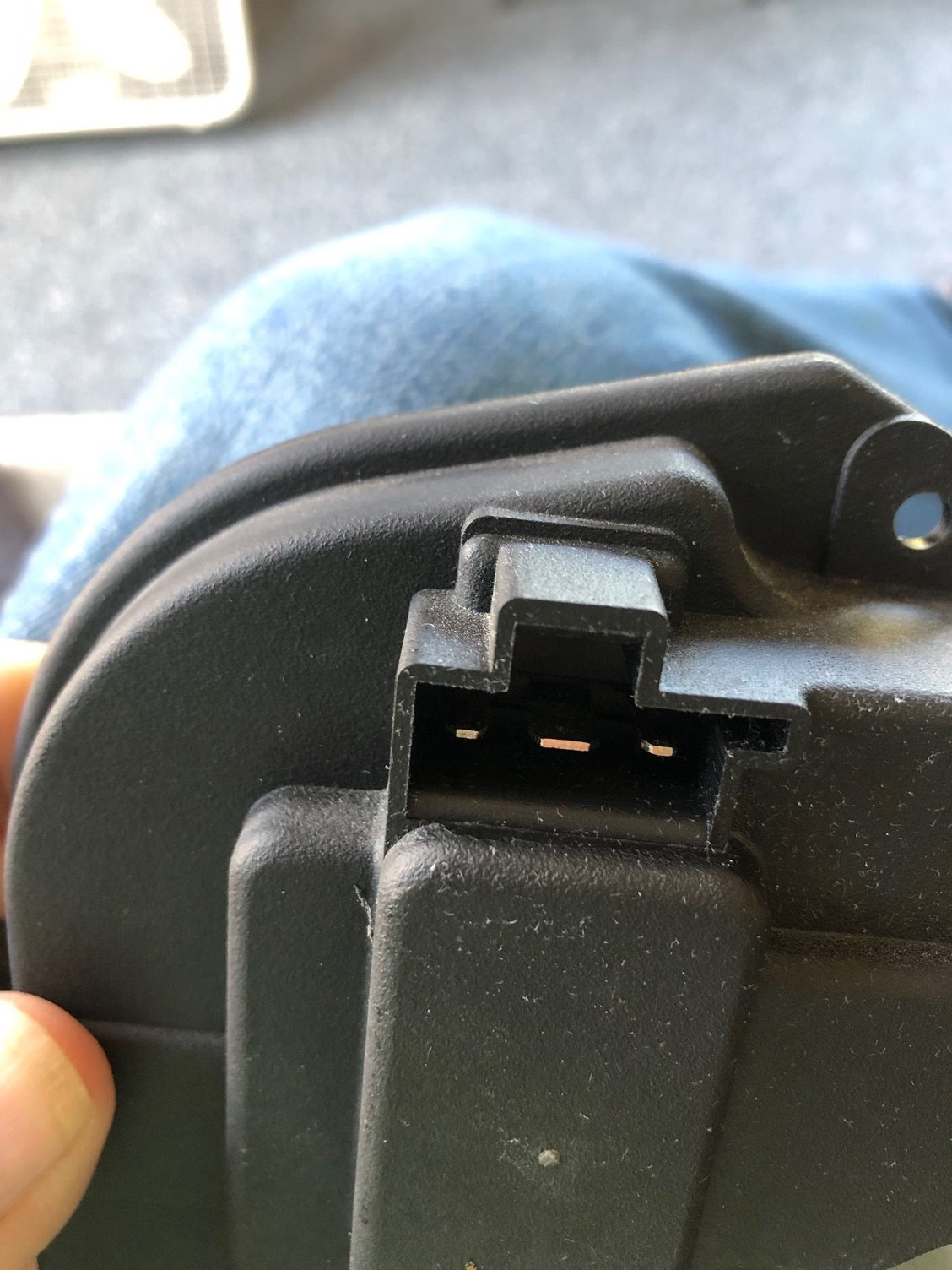

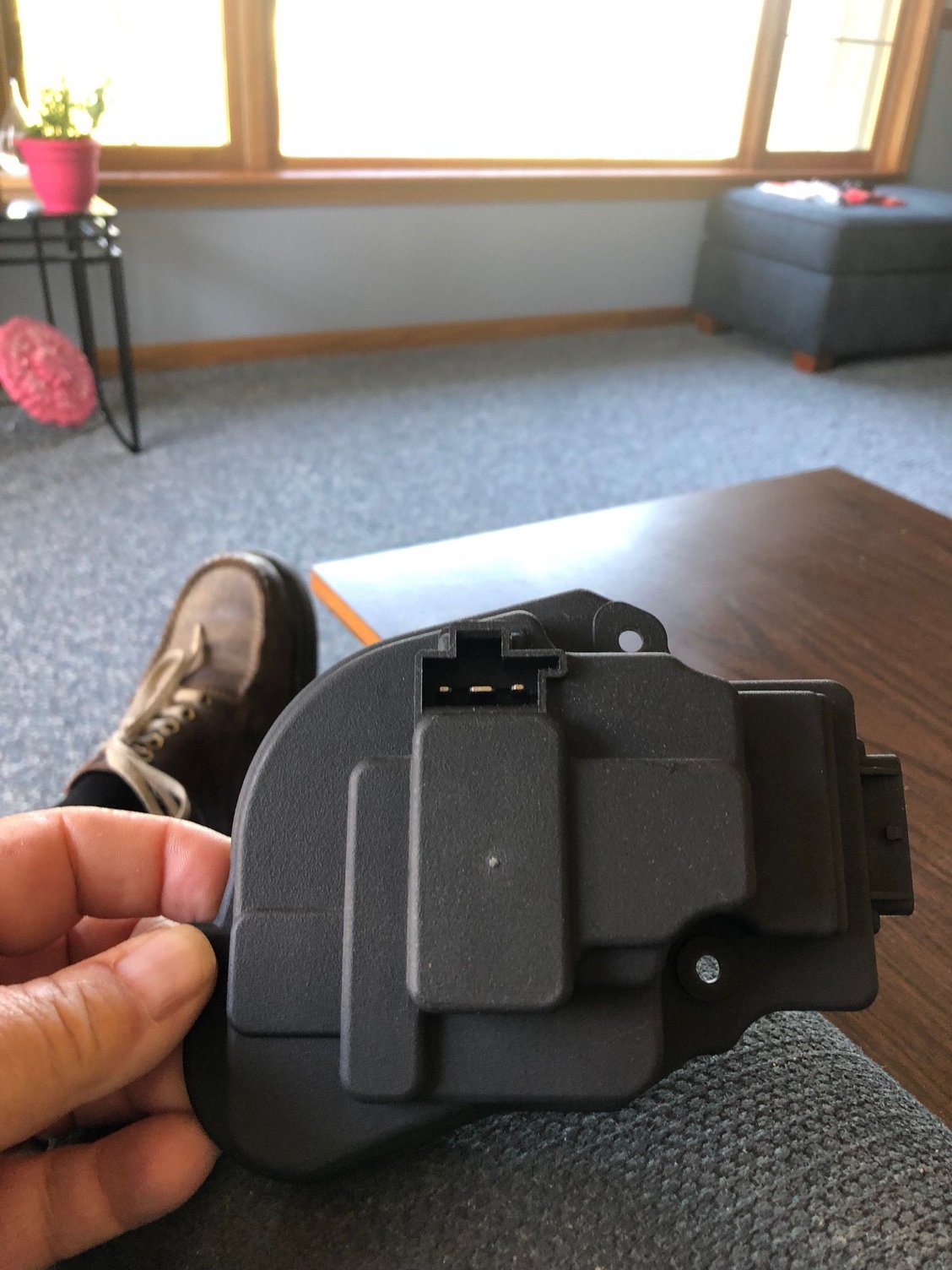

I bought a new one about a year and a half ago. Had to return once as they have two different connectors. I got the right one but it did not fix my washer issue so I put the old one back in. It is new and I would be glad to sell. I will post a picture of the connector. Dan

New.

This is not a GM product but a repro. Dan PS: A lot of the repro products are made by the same companies who made the original as it would not pay to gear up to make these from scratch as the market is too small.
