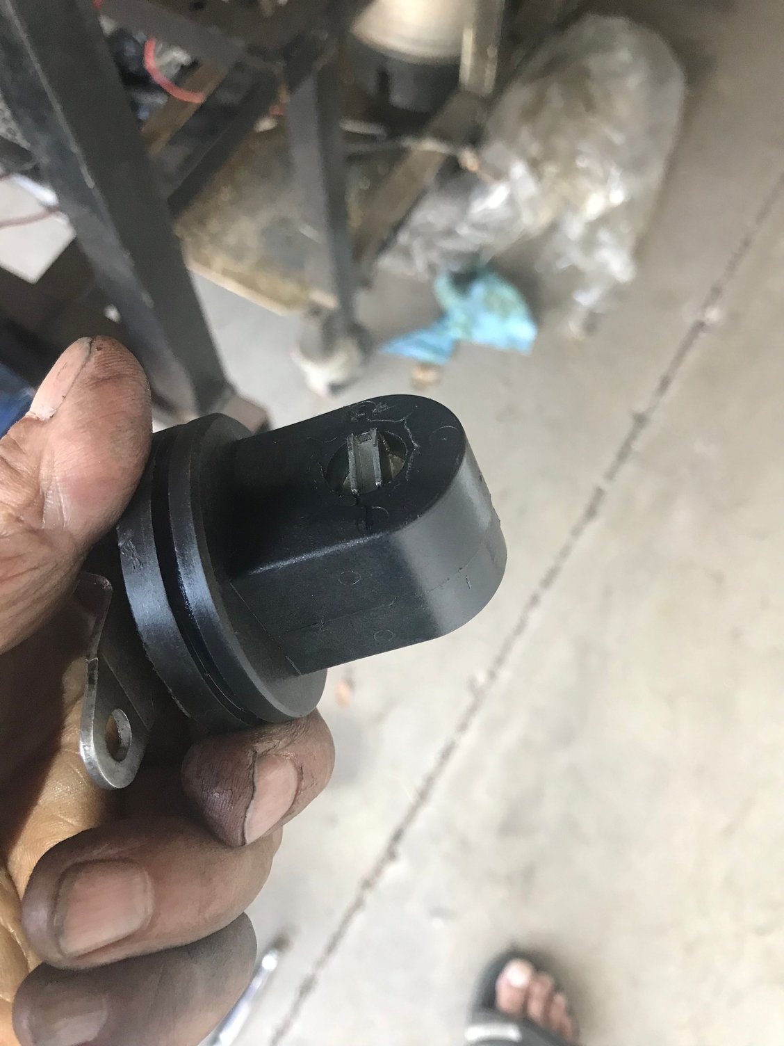

It is interesting to note that i swapped in a 91 firebird trans into my car.
the firebird trans did not have the torque arm mount, so i removed the tail housing, only to find that the shafts were different .
i removed the 86 shaft and installed it into the 91 trans. It had a red gear, so i just swapped over everything.
the firebird trans uses a reluctor, not a gear. I bet your new trans has a 4 pulse reluctor instead of a gear driven 2 pulse vss.
get in the guy’s face and request to see the vss. It’s a matter of putting the car up on the rack, and removing the 2 pin plug, and one bolt.
then prying it gently out of the hole.
the reluctor is a black square thing with rounded corners.
the 87 vss has a gear.
you make the call.
