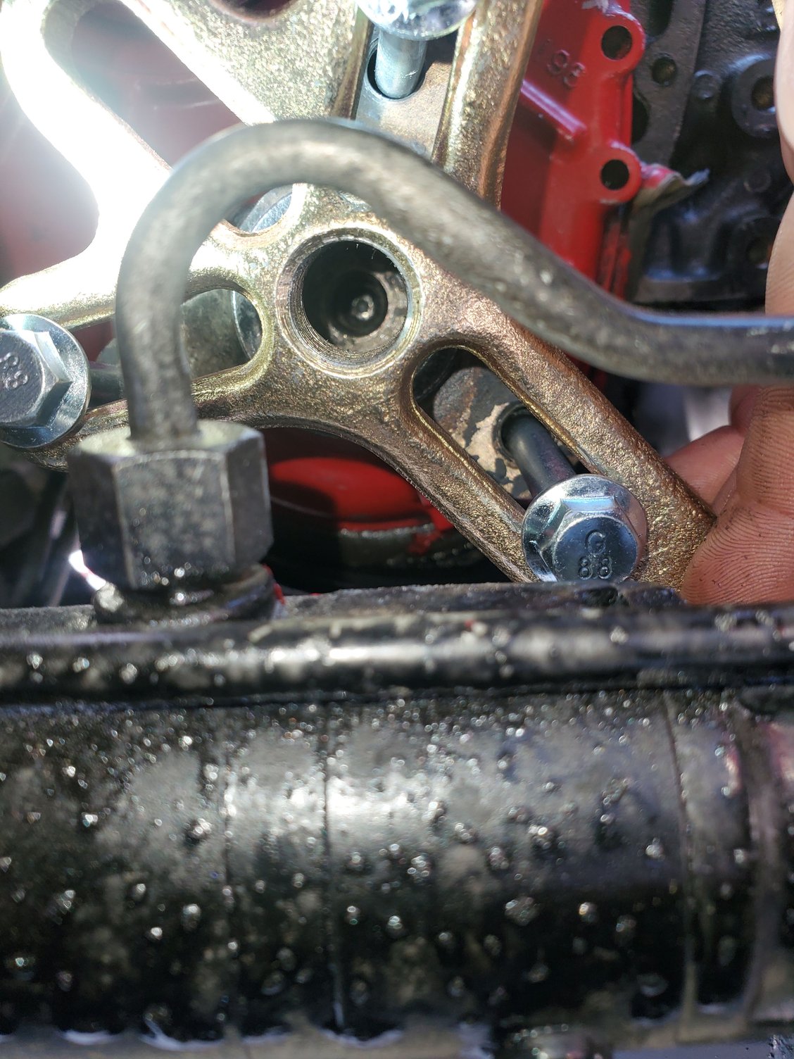

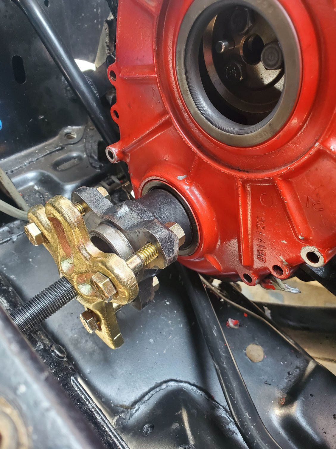

Well I heated it up a bit, 3 mins? But maybe I'll need to heat it for about 5-10 mintues straight, the hub area front of the timing cover and behind, to get the whole shaft surface area. I noticed that every time I go to tighten, the rod and extension keep angling off, making things crooked, so maybe it's not letting it go out straight.. even though I see that the 3 bolts I have in there are straight and the nuts at the ends are inserted equally, look at first picture, it's got tension, it's not centered. I took a pic of the inside, it's hard to see but there is some rubbing on the crank nose, could this be why it sets itself un-centered? Surface damage from past attempts? Should I try this again with a slightly longer crank bolt? 7/16 20, so it'll be centered.. maybe red hot will work?

I'm not sure, w/o being there, why your geometry is not working -why it' s not staying straight. First, my puller has a device that fits inside the hub, and has a cone depression in it to guide/center the point on the end of the threaded push rod. W/o that, I guess I'd loosen the three bolts a couple turns, then tighten up the main push bolt slowly until it starts to go askew....THEN I'd try to tighten which ever of the three bolts I think would square it back up....and if that worked, then tighten the main push bolt some more.
I think more heat too. I would try to NOT heat the crank snout itself, but really try to heat the hub just outside/in front of the seal, around the hub...or at least opposite sides of it. I'd want to be trying to get the hub to expand, and not the crank (if that's possible).
Finally, if you could tension up the puller, then HIT the end of the puller bolt with a sharp blow (or better, an air hammer), then tighten more, then hit, then tighten, then hit.....but I don't think that you can get a hammer or air hammer in there, so I'd focus on squaring up that puller and heat.

I'll try to get it as even as possible, I was trying that earlier but I was kinda BS'ing it because in my mind I was thinking the worst, I'm very positive but this crank stuff scares me, hopefully the crank bearing are good.. I got some other bolts that screw in directly on the hub threads I'll try with those for an even fit, without dethreading anything of course. I'll heat it up more on the outside. And maybe even hit the end of the pullers rod with a hammer, it fits I have nothing up front. Also, should I leave it in drive or overdrive, neutral? Which gear would you leave it on? I cannot remember which gear I tried last time.

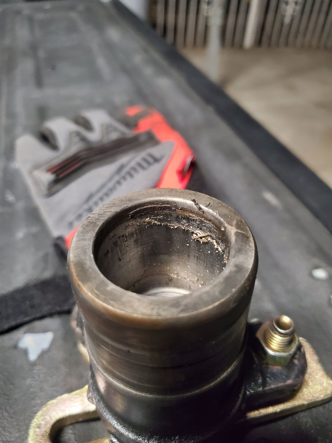

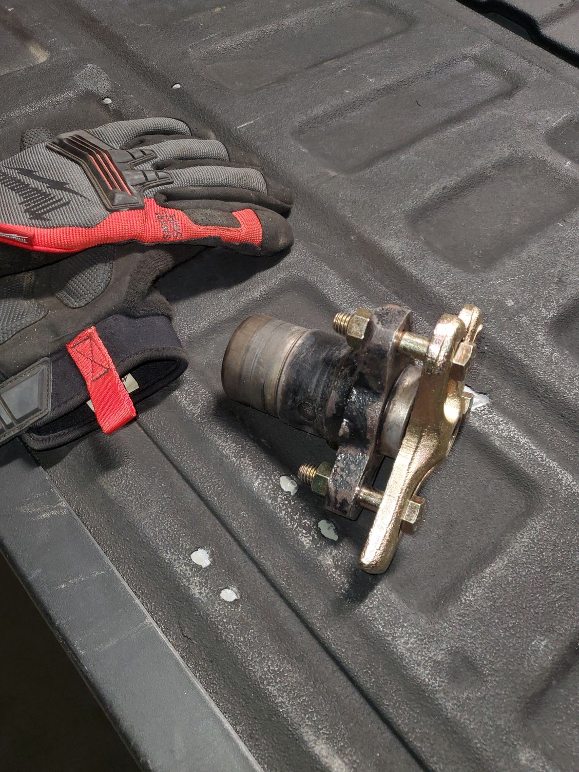

Got it off!
With the help of my brother, we torched that hub for maybe 8 minutes straight and decided to go all out on the puller, I was holding a cresent wrench on one of the ears to keep the hub from turning, and my bro was going ham on the puller, we thought it was going to dethread, we used more force than the AutoZone puller, but our O'Reilly puller I got the other day didn't get much damage! Buy the O'REILLY. The hub was so hot it was smoking for a couple of minutes after the heat. And I can feel the radiation from heat on my face while I was holding the wrench.

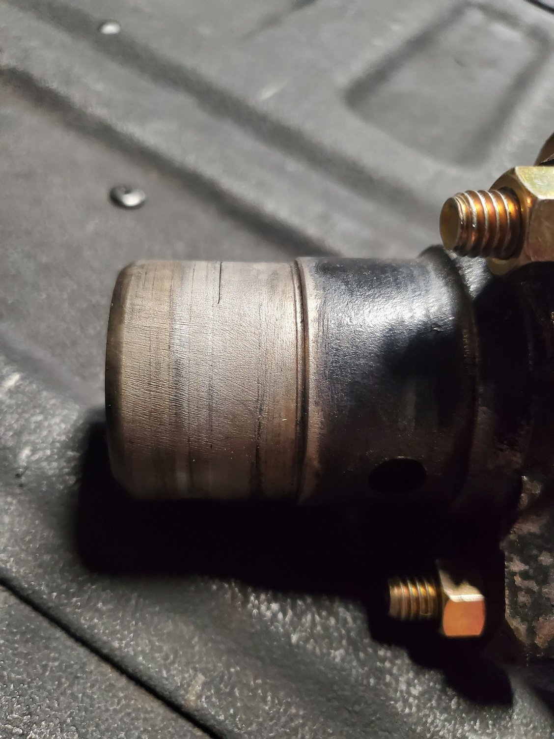

Looks like the Hub cavity has some damage from the tension, I guess it really was coming out crooked. I'll be sanding it with something light to smooth it out more.
Take a look at the outer surface, it is not really worn, I can barely feel a thing running my finger across it. I don't think I'll need a sleeve, it never leaked from there anywhere.
Thank you so much Tom! Up until I first posted this, I didn't know that heating was an option, and when I heard some people throw that idea on some other threads, I didn't think it was even a good one. Awsome, now I can finish up my build.

Killer! Strong work. That is an odd mark on the ID of the hub. Glad that it came off, in the end.

Glad it's out. The witness marks on the inside of the hub look like corrosion to me. That would explain part of why the thing was seized on there. You said it hadn't been on there very long so it's puzzling to me that it was corroded if that's the case.
I would recommend that you get a sleeve for that external sealing face though, or just get a new hub. That one looks like it will eventually (or right away) have a problem sealing well and that's not a place that you want to have any leaks. It's worth the extra effort / cost, I never like to mess with roughened up metal near a front seal surface.
Good work!
