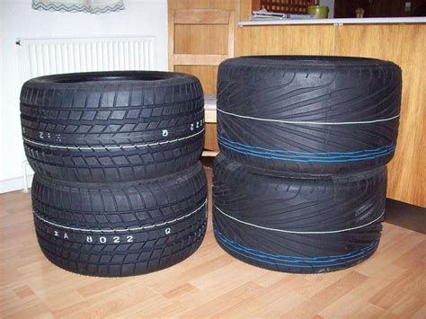

Has anyone tried putting a 315/zr/ 17 tire on original rear sawblade wheels?
I have a 1996 Vette.
Just asking if they will fit or rub anything?

The 315 was meant to go on the 17x11” wheel not the 17”x9.5” wheel so it will fit but not maintain the correct profile. I am not sure if it will rub due to the sidewall protruding more due to the narrow rim. If you can find a set of 17”x11” rims then you have no issues.

Someone will be along to give you a dissertation on what you can and cant do and choice of tires.
The 315 is designed for a 11 inch wheel, for most 315s.

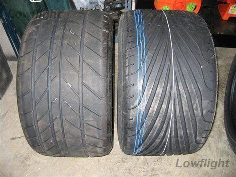

Some are real wide, some are narrow as the manufactures aren't either measure in a different spot or wherever they want.
Look at a Sumitomo 315 vs a Good Year Eagle F1 315 tire from a while back. And the Good Year vs a BFG KD, almost identical in width. Huge difference in width, but same numbers.
Some get that some dont..
But to make a long story short a 275/285 is meant for the rear 9.5 inch wide wheel currently on your 96.
And for the 96 you want a 17x11 with 50mm offset to fit best. The 17x11 with 36mm will stick out quite a bit.

I'm late to this party, but...you DO know, because multiple people are telling you this is a bad tire fitment. You can also just look up the tire manufacturer's recommended rim width for their 315 tires. I don't think you'll find any radials in that size where they recommend less than a 10.5" rim width. A 315 can be installed on a 9.5" wheel, but that doesn't mean it should be installed on a 9.5" wheel. If you buy and install these, you're like the guy who built his own steam-powered rocket a few years ago so he could see for himself if the Earth is flat or spherical. He died, you know...

315s should not go on a 9.5" wheel.
