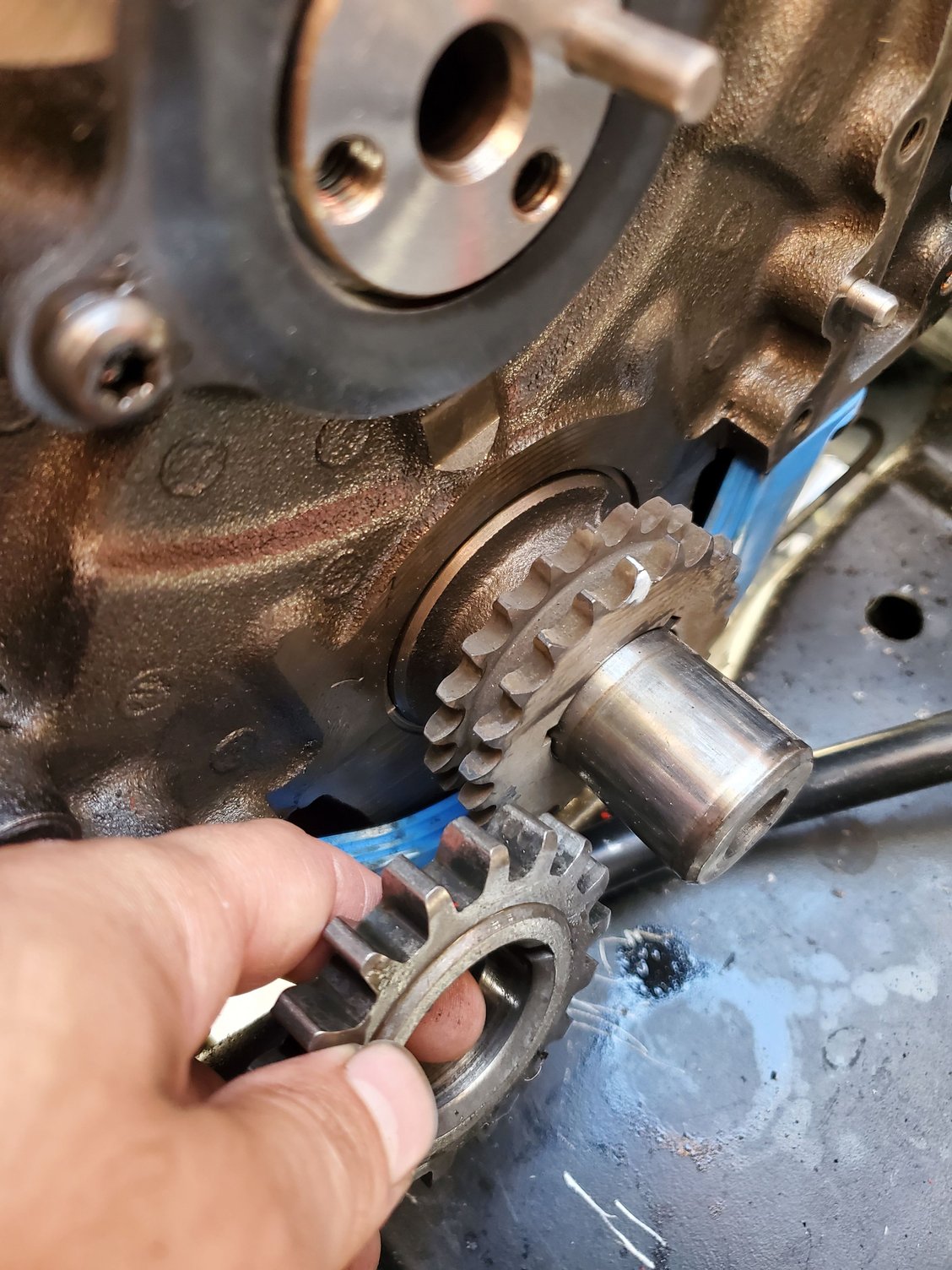

The more I re-read the thread, the more I think he better make sure his cam isn't installed way out of time. My little brother once installed an adjustable timing set using the wrong dots and ended up with the cam 120 degrees out of phase with the crank. The result was valves leaving witness marks in the forged pistons that slammed into them.
P.S. - Everything on YouTube is not necessarily the gospel truth. The guy in the first video is a blithering idiot.

I thought I had a pic of the new timing set up, but no this is the closest one I got. It's hard to see the crank gear, it's discolored because I heated it up just a bit for it to slide in, but that white mark is 0 degrees, checked 3 times. You can also see the cam at the 3oclock position ready to accept the gear & chain. And dots were centered perfectly when I finished, we turned the crank probably twice 360 and it came back lined up both checking 180 and 360. So maybe it's not out of time, I'll see if I can check with a flashlight in the cover to see the timing lol!
I'm going out now to try this again. Restarting

Your cam dowel does look like it's in the right location, but that doesn't mean it wasn't turned in order to install the cam gear. If memory serves, those type of sets use a circle for 0* cam timing, and a triangle and square for advanced / retarded. As long as you used the circle on both you're golden. If the symbols got mixed up you're probably experiencing VTP interference when you turn the engine over with the valvetrain adjusted.
You can check that cam timing is in the ballpark by removing all the pushrods and setting the crank at TDC. If you're on #1 TDC the #6 intake and exhaust lifters should both be off the base circle. If you're on #6 TDC the same should happen with the #1 lifters. Just watch them as you rotate through TDC - exhaust should be closing and intake should be opening on the cylinder that's 360* (crank) / 180* (cam) off TDC.
If you adjust lifter preload like I mentioned earlier and everything moves, you're likely just experiencing the load of the valvesprings that makes it difficult to turn. If you have the spark plugs in it'll be even more difficult because you'll be fighting compression. Also, it's normal for the lifters to bottom out like you describe - the valvesprings are simply overcoming the plunger spring in the lifter. That will go away when you have oil pressure.
