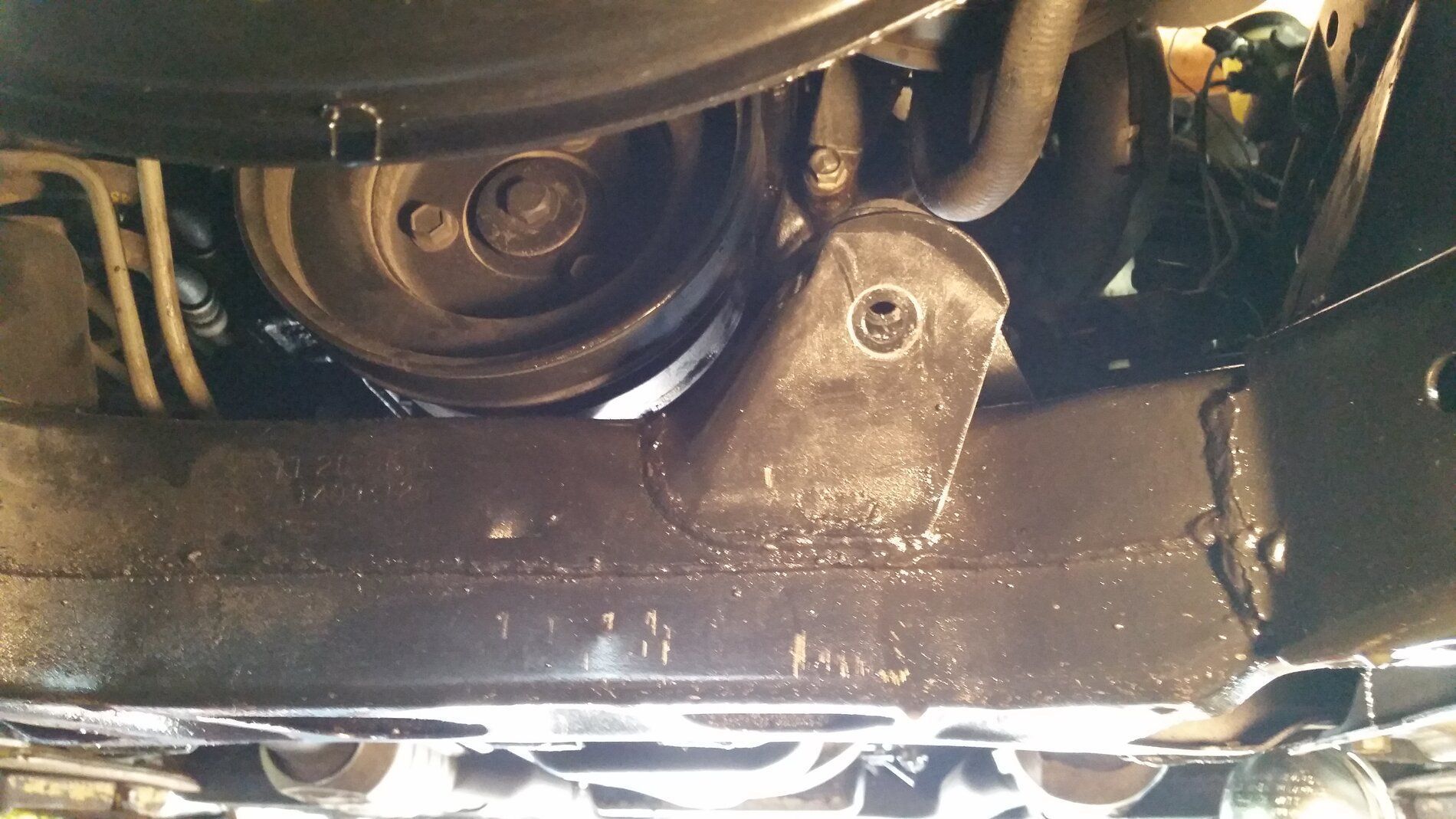

Yes, if it is the same as my '87, it will come out the drivers side. If I remember correctly, once I knocked it loose toward the drivers side, we just simply had to rotate it a little to clear coming out.
Unfortunately, I don't have any in progress pics of the removal. But, this is what it should look like after you get it clear.
